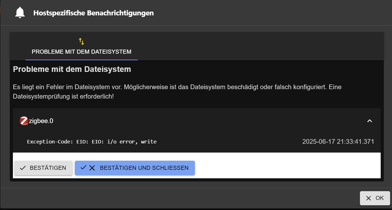

I’ve been having a file system issue for a few days, which points to a Zigbee issue. I was advised to update the firmware on my Conbee II. In the video tutorial from dresden-elektronik, I don’t see any distinction between deconz_Conbee II and deconz_Conbee III. Is this correct, and can I also use the latter for the Conbee II?

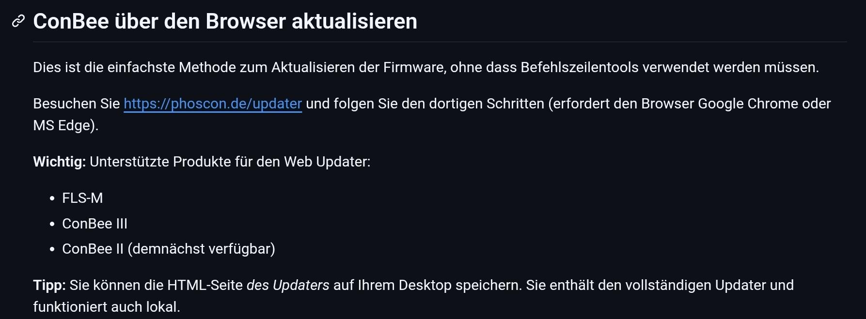

I have a Conbee II, but there is no option via the browser yet.

Ha yes first time I tried the browser application Phoscon Firmware Updater
And nothing about the conbee2.
@Onshuis It seem you have the last firmware version, have you just try to unplug/replug the conbee ?

The problem described at the beginning persists. I tried a second ConBee II. It worked immediately. The error message hasn’t changed. I assume the firmware is on the stick. Therefore, it’s unlikely that the ConBee stick is the cause of the error message.
You haven’t a window machine ? This procedure works generaly fine Update deCONZ manually · dresden-elektronik/deconz-rest-plugin Wiki · GitHub
