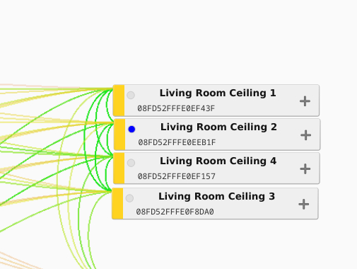

I discover them easily through the Phoscon App, and add them to my living room group. They work fine, but as soon as I call a livingroom scene they go off and stay permanently off (even though the UI says they are on). I have tried removing all scenes and recreating new ones. Same outcome. When I press the toggle (via Phoscon App), I can see the light receiving the signal in the deconz app.

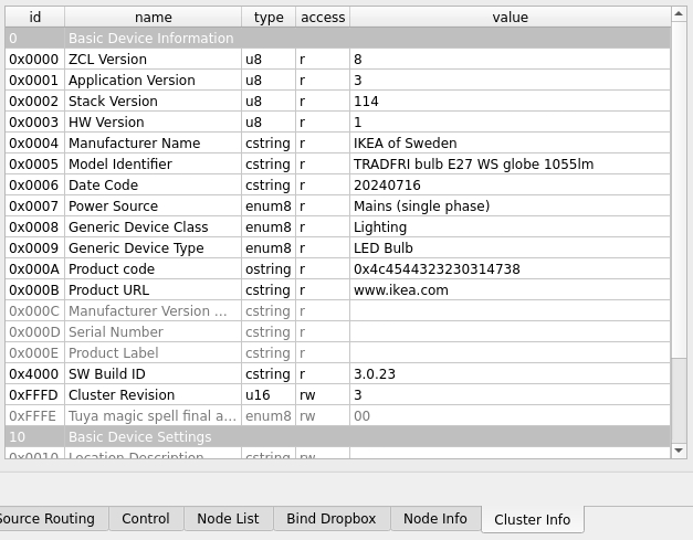

The situation slightly improved after I manually (via OTAU) upgraded the bulbs to the latest fw 3.0.23. The communication has become somewhat more reliable (ie the bulbs did come back online after changing scene) but they keep eventually getting stuck in some on or off state (not responding to the zigbee commands).
