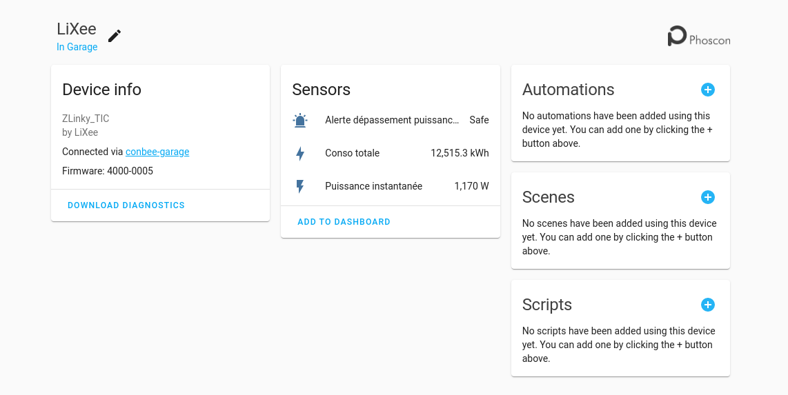

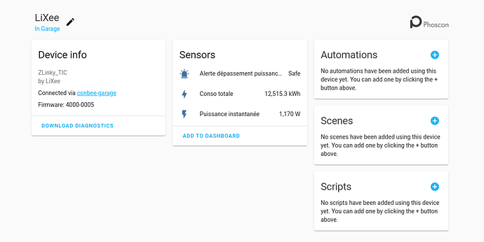

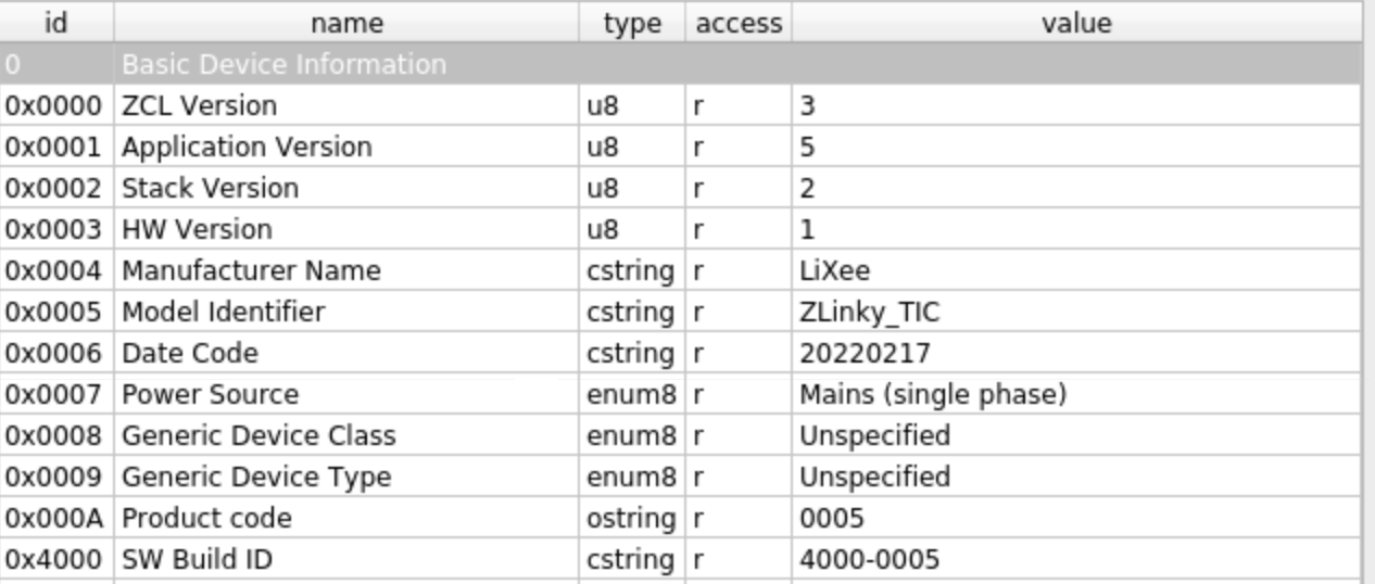

Thanks @AdrienBigot for the help. I have the following info from Deconz
It seems that the firmware version is 5.0. Am I right ?
@AdrienBigot but you have this issue too ? I don’t see something about disconnection on the firmware changelog.
The firmware number is “4000-0005”
Yes, I have the same value and I confirm that 005 is the latest revision. Before upgrade my firmware to rev 5 the value was 4000-0002.

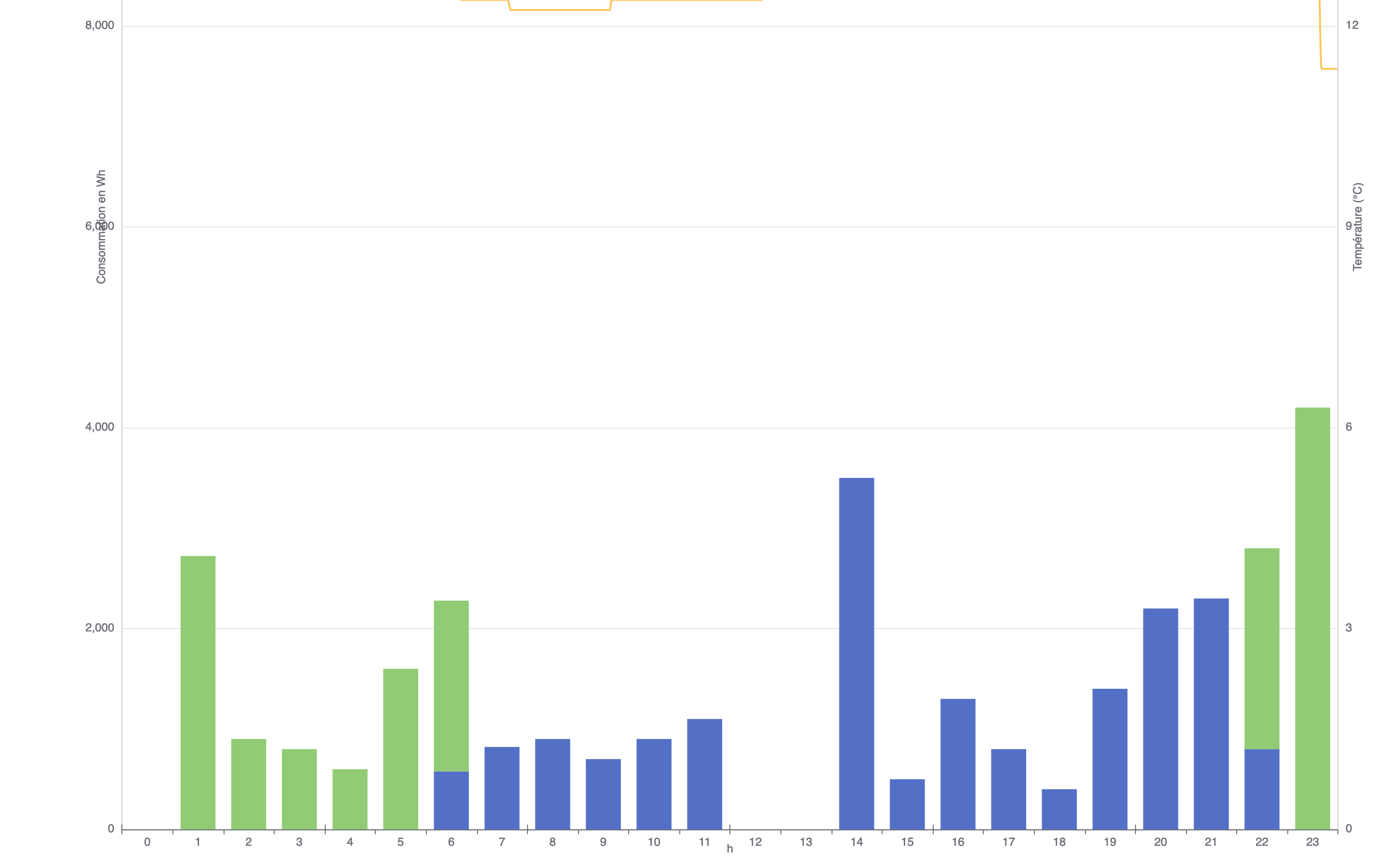

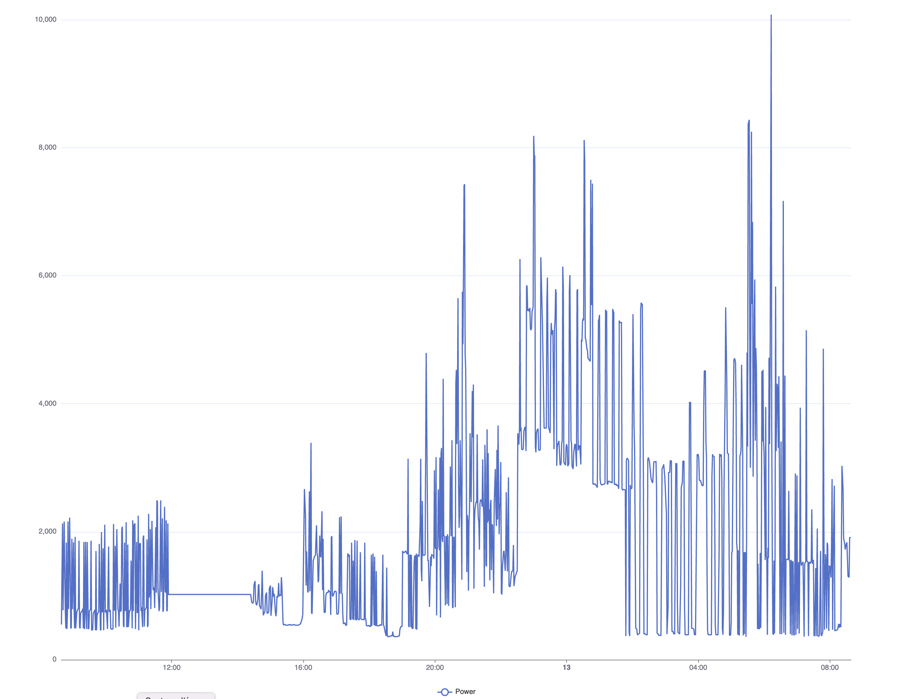

After increasing the interval, the situation seems to be much better now. I only observed a lack of communication for a few hours (see the figure) like I had before.
This is not a problem for my home automation system. However, there will be an error in the reporting of the consumption for the time slot where there is no communication (between 12:00 and 14:00 in the figure). The consumption will thus be reported in the next hours (14:00-15:00) when the communication will start again. See the figure below.
I will increase the reporting delay to 600s to see if it will improve the situation.

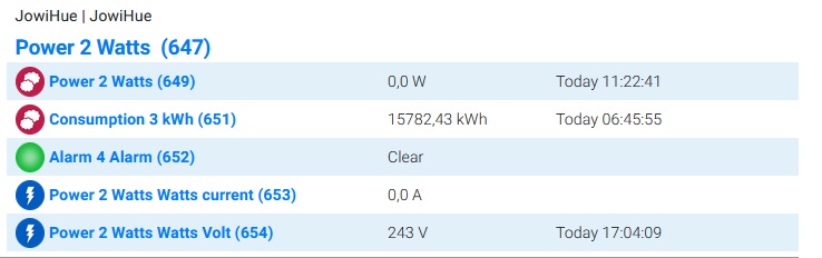

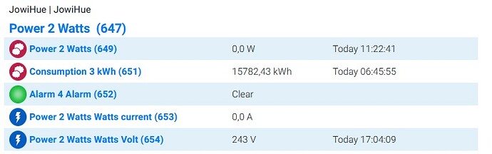

Hi Smanar, I saw in your post that everything should be available in version 2.15.1, and I noticed that this version is now available. So I uninstalled deConz and downloaded and installed 2.15.1. But nothing seems to have changed. I then tried changing the DDF to the one you posted for Standard and Production, but again, nothing seems to have changed. I am supposed to send w.vuyk something from Homeseer so that he can do something with the plugin, but I am not sure if it is too early for that yet. What should I do now?
You are using this one LiXee ZLinky_TIC DDF File - #60 by Smanar ?
I don’t remember if you use the GUI or not ? To use the “reload” feature.
If I m right with this new DDF if you llok on sensors (Phoscon / help / API Information/ sensors) You will see for this device
Values can be 0.
Yes, I am using that DDF file, and have done the reload. In Phoscon / help / API Information/ sensors, I do see the three things you listed. However, in HomeSeer, there are 5 devices (see screen shot) and these devices do not correspond to what I was expecting. “Power 2 watts” may be the current load on the system. This is hard to check right now because the solar panels are providing all the electricity and I am not consuming any electricity from the grid. In any case, I really don’t need this measurement because I have a cable clamp that gives it to me via Z-wave. “Consumption 3 kWh” seems to be the metering for HC. That is correct, according to the Linky display. The other 3 devices I do not need. What is missing is the meter for HP and the meter for production.
