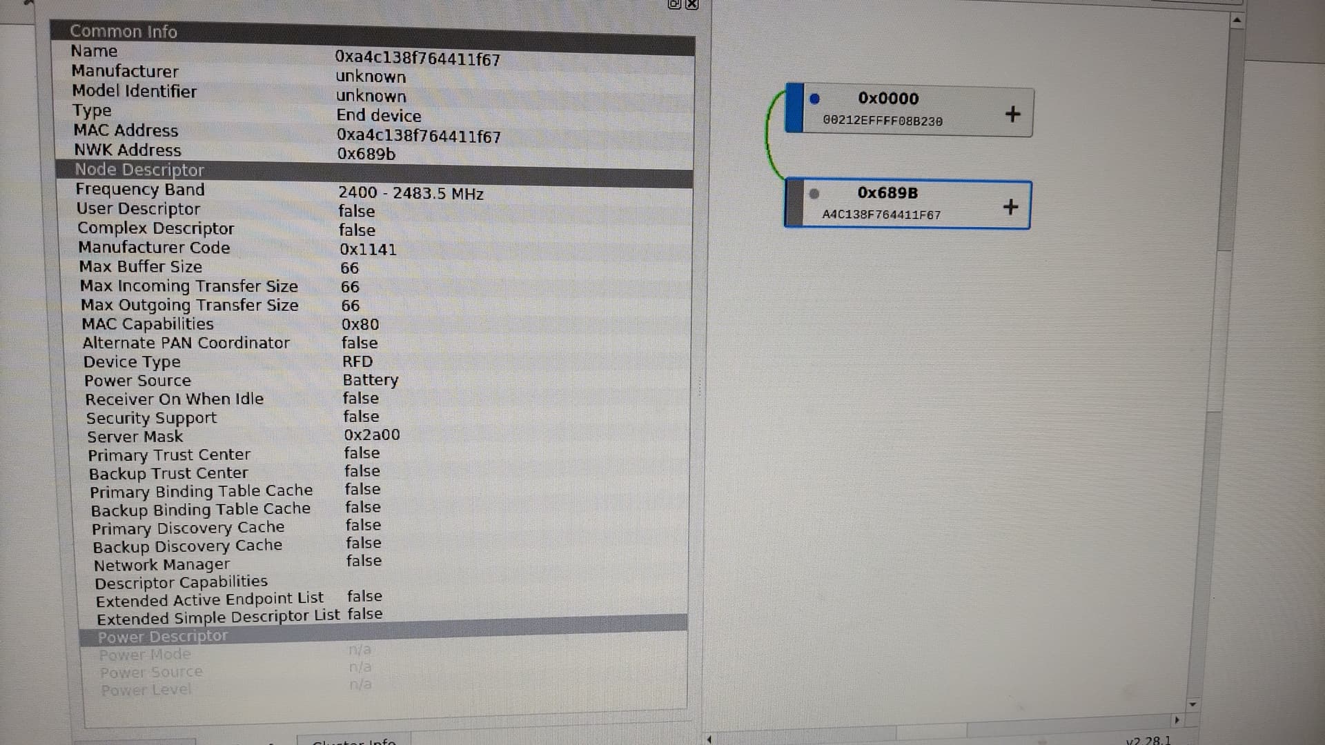

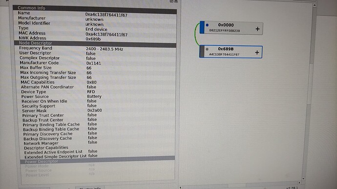

Hi, this is what I see in DECONZ (sorry for the image quality).
Thanks.
Roberto Mandelli
There is no problem with the image quality ^^. It’s just to see if it’s a just clone or a new device.
But there is a problem, You have “Unknow” as value. It’s because it’s lazy device, they need to be awake to get value.

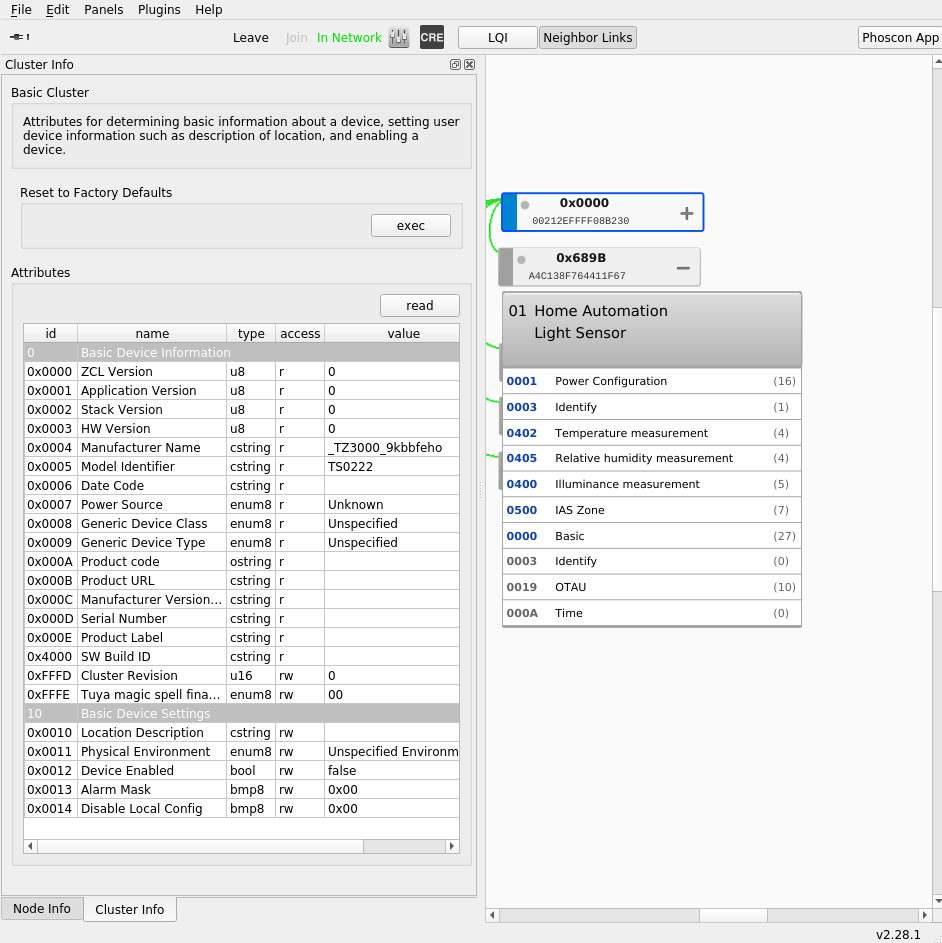

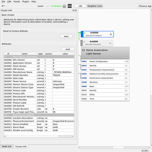

I captured the data from “Basic” 0x0000 and am sending you the image.
Thank you for your patience.
Roberto Mandelli

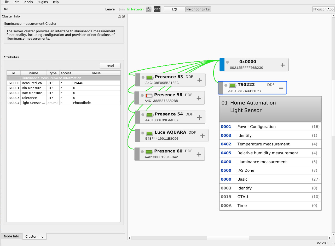

P.S.
When selecting “illuminance measurement” 0400, the value of the “0x0000 Measured Value” attribute changes based on the brightness.

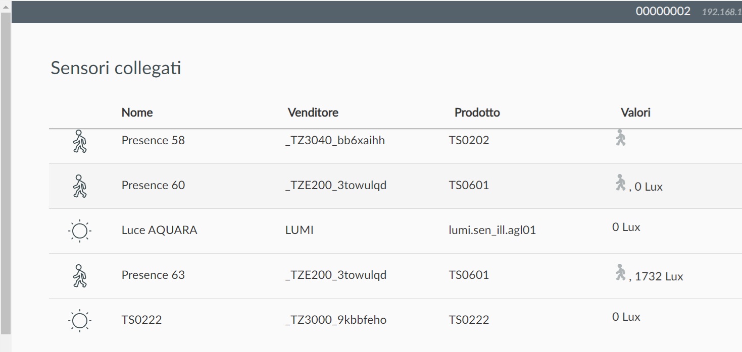

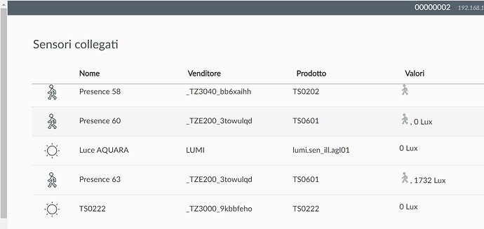

I named the file _TZ3000_TS0222_Tuya_Luminance_sensor.json and placed it in the /usr/share/deCONZ/devices/tuya directory (I don’t have Docker).
The device is recognized by both deCONZ and Phoscon App, but while on deCONZ the “Measured Value” field follows the light intensity (see photo), on Phoscon App it always returns to 0 (see photo).
Thanks
Roberto Mandelli
Ha ? Can you check the complete device json in Phoscon/help/API Information/sensor ? You will have state/lux and state/lightlevel.
Perhaps this device is locked ?
