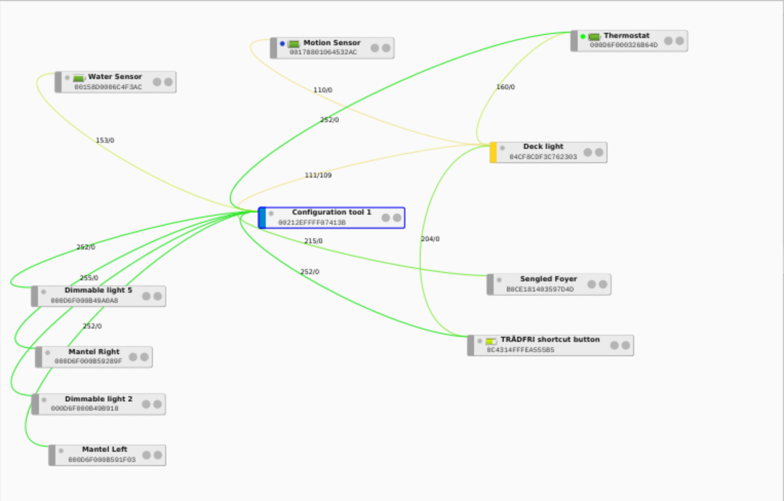

Sure! Do you mean like this:
“Deck Light” is actually an Aqara wall switch, so it’s always connected to power and is acting as a router just fine. The four lights in the lower left are Nanoleafs, and the Sengled is labeled.
Sounds like I might just be out of luck that Sengled doesn’t support it. I bet Nanoleaf doesn’t either. I might need to pick up a couple of smart plugs to place around the house to act as routers.
