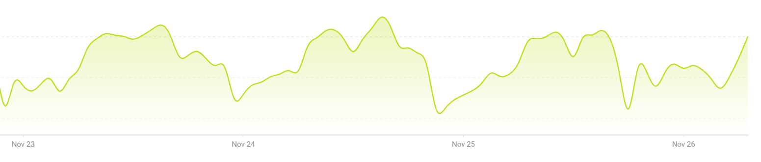

Is anyone else having issues with Blitzwolf BW-SHP15 Plugs on 2.13.2 on Synology (new community Docker image: https://github.com/deconz-community/deconz-docker#notes-on-migration)? Even when all devices connected to plugs are turned off at night, I still see power readings alternating every second or so between 0W,54W,0W,54W in Homey (3rd party application using deconz websockets). This happens for multiple plugs. Homey “Insights” shows all devices as if they were turned on all the time (should be 0 at night):
When I look at te Power measurement cluster in vnc however, it stays at 0 all the time, so it looks like an api issue in 2.13.2? BTW: Can I safely downgrade to 2.12 to test?
