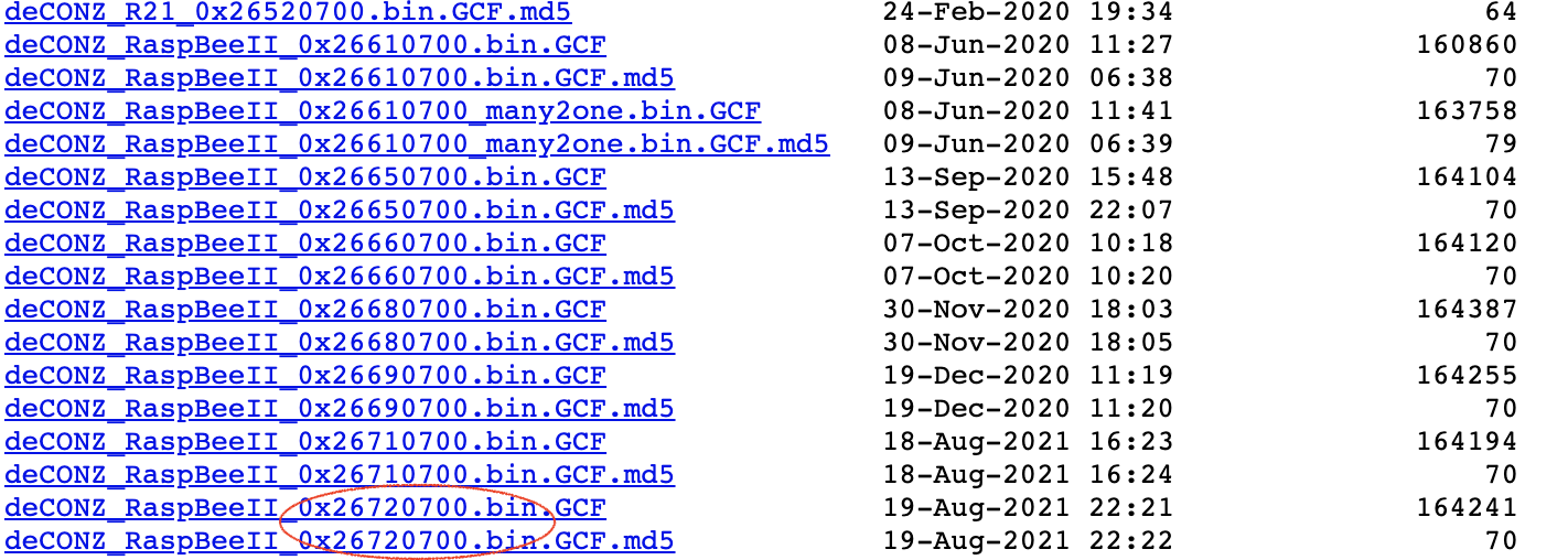

However, my Raspbee II firmware version is 26690700
but when I look in the FTP folder, it appears that 26720700 is the latest
http://deconz.dresden-elektronik.de/deconz-firmware/?C=M;O=D
My Phoscon says its up to date.
Am I reading the version numbers wrong? Or is my Raspbee failing to update?

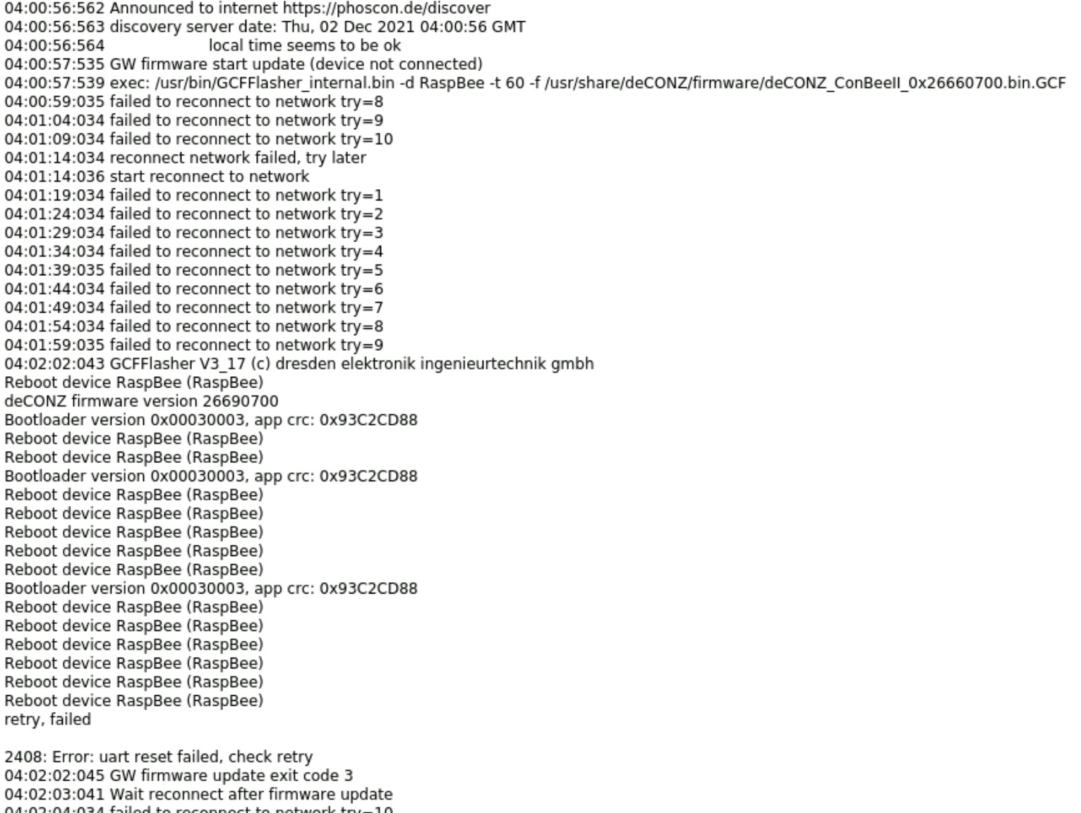

If I reboot the Raspbee II, deCONZ tells me there is a firmware update - then I see logs which imply that deCONZ is attempting to install a CONBEE firmware…???

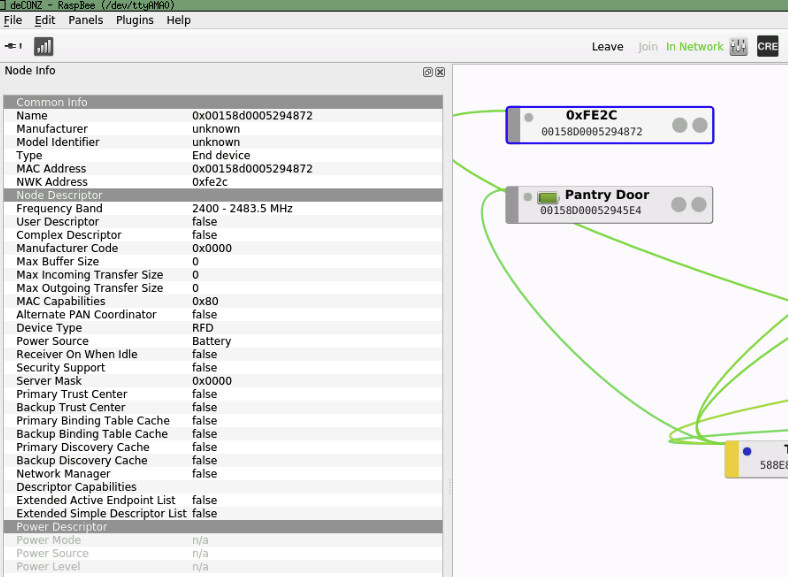

First things first, the device you try to pair is supported i think. For that to make sure, we need to see it in deCONZ. Can you show a screenshot in deCONZ for that?

Nothing to see with the issue, but he is right, it’s normal deconz try to update a raspbee with a conbee firmware ?
Hi @Mimiix - here is a screenshot of the failing Mi sensor:

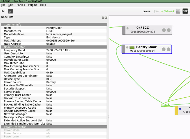

Also, here is a screenshot of a successfully paired sensor of the exact same model (it was paired a few weeks ago)

This could help maybe
Hi @Mimiix Thank you for that link.
I tried the suggestions on that page in order.
The first one (re-reading the descriptors) did not help.
Deleting the node, and re-adding - then opening/closing the sensor while Phoscon was searching, instantly did the trick - the sensor was added and fully functional.

Back to my original post - can you comment on my deconz installation attempting to install a Conbee firmware file on to my Raspbee II module?
Because it looks like there is an update for the Raspbee II, which I am not receiving as a result.
Yes I am running the standard HA for Pi image, so it is HomeassistantOS.
Thanks
The Firmware update doesn’t work on HA. You need to update on a native OS :slight_smile:
