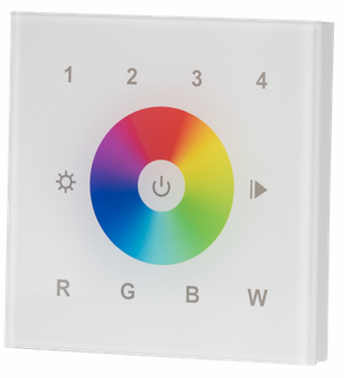

## Device
- Product name: 511.544 Zigbee 3.0 Wand-Dimmer für RGB / RGB+W / RGBW… / RGB+Duo LEDs, Touch R, 4 Lichtzonen | weißes Glas
- Manufacturer: iluminize
- Model identifier: ZGRC-TEUR-001
- Switch
- Remote
- Iluminize has branded this device. About 15 month ago I bought the same one (511.544) from the iluminize-shop. The manufacturer (Basic Cluster) is not iluminize but sunricher.
- not battery powered
- product page: https://www.iluminize.com/de/shop/led-steuerung/wand-dimmer/product/499-511-544-zigbee-wand-dimmer-schalter-rgb-rgbw-rgbws-led-4z.html
- picture:

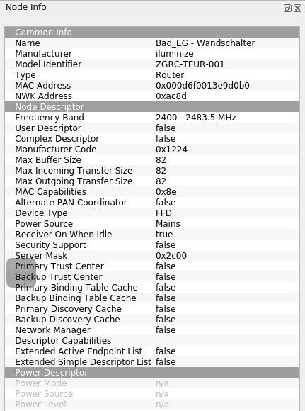

### Node-Info:

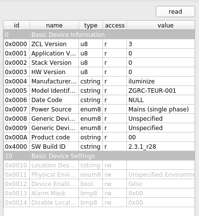

### Basic

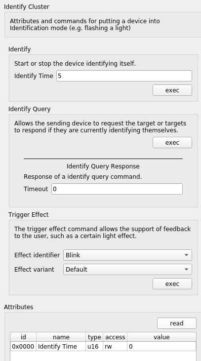

### Identify

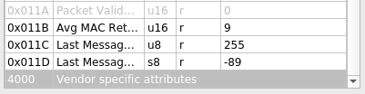

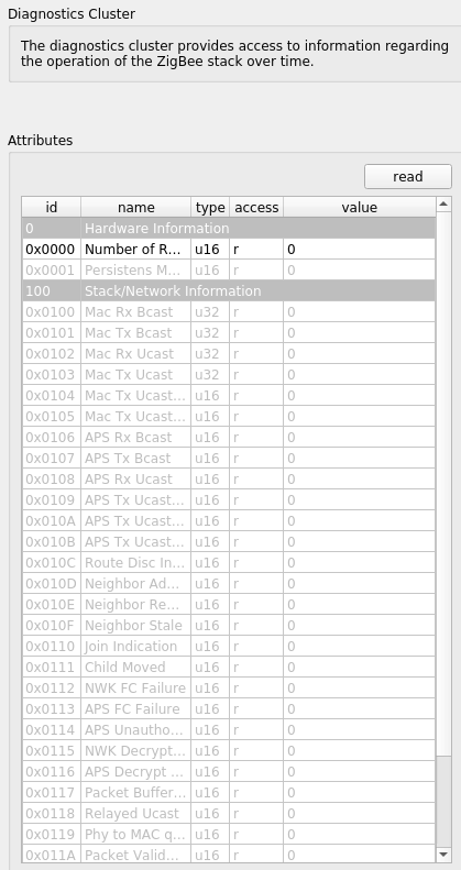

### Diagnostics
