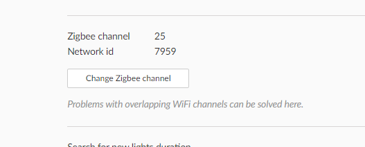

Just a thought; have you tried different Zigbee channels?
