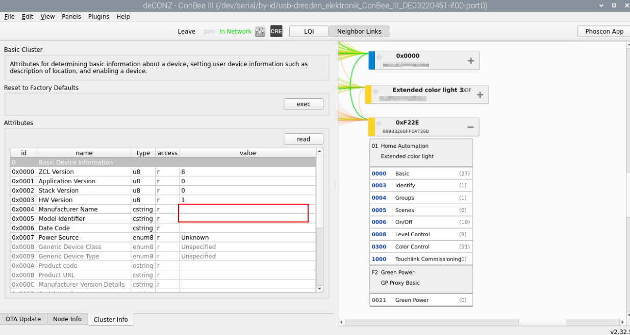

In deCONZ, like on most other Coordinator forums I have read e.g. [New device support]: Ikea Kajplats Bulb (not working) · Issue #30211 · Koenkk/zigbee2mqtt · GitHub, they show up with no Manufacturer Name and Model Identifier. Also in deCONZ:

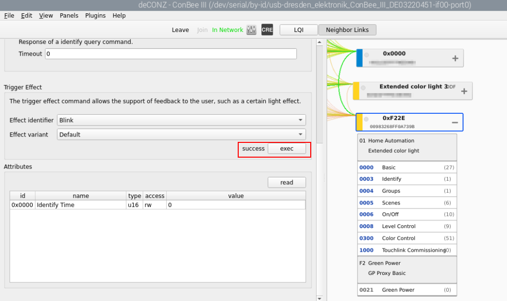

I am however able to communicate with the bulb e.g. from the Identify-Cluster, and it joins Zigbee Mesh with no issues:

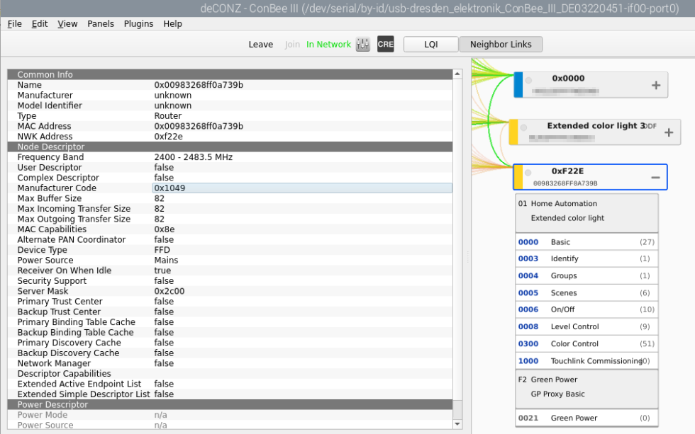

Node details:

But the problem is deconz use the modelID/Manufacture name to reconize device, I don’t think the code can work without them, deconz will ask them again, up to have them.
