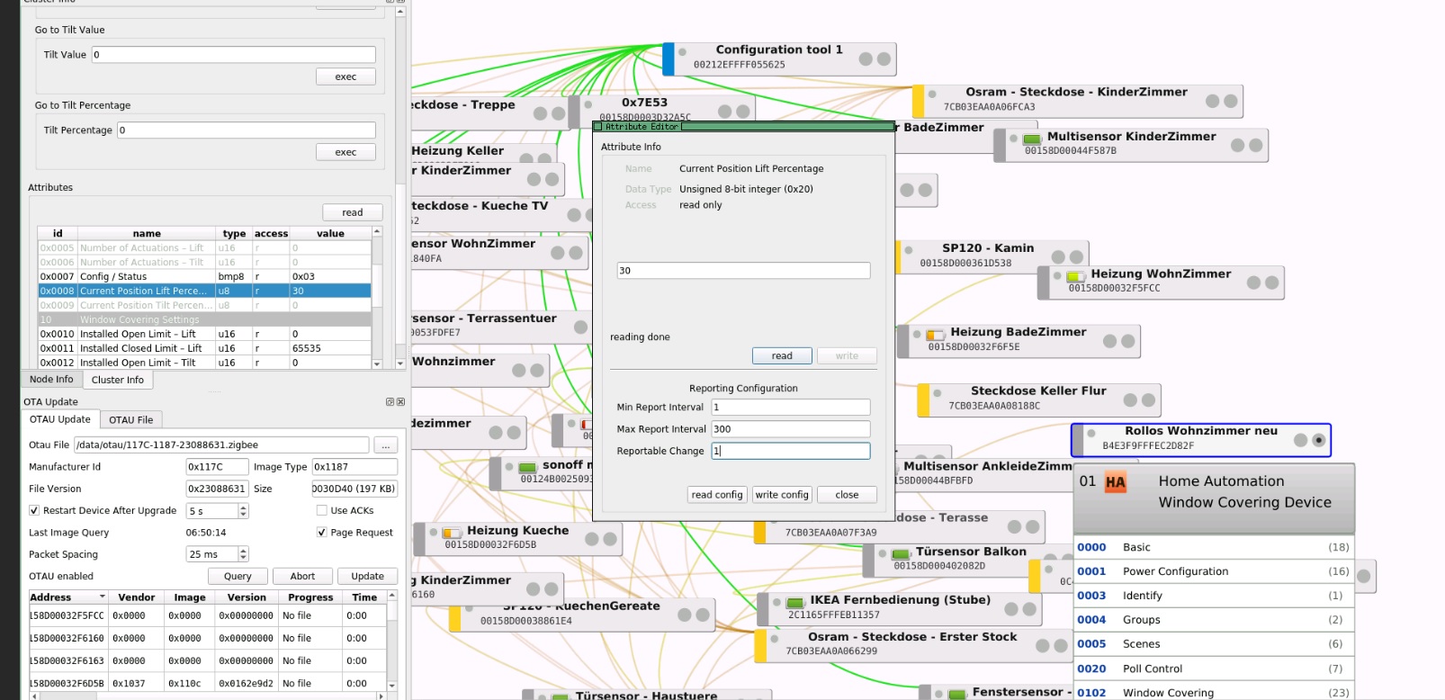

in tried to look in phoscon and go under “window covering” when i there press “read” the correct values are pulled and send to Homeassistant, but only when i press read.

I’ll grab the Ikea Kadrilj for testing this week (I think it’s similar to Fyrtur).
The Kadrilj already has a DDF, but still at Bronze status, which has proper polling/reporting config support, we can derive the one for Fyrtur from it and bring them to Gold status.
