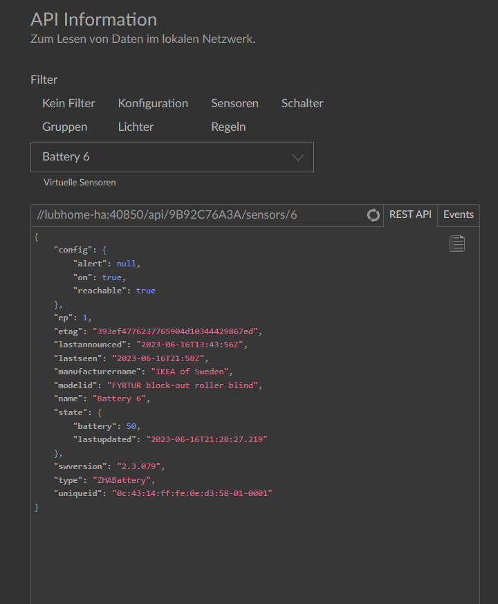

The result of GET /api/<apikey>/sensors/<id> for that battery sensor for instance.

You can get it first using Phoscon (Help/API information)
Ok, so in Phoscon I can’t get any API Information about that “battery” device, because it isn’t shown there. The api information only shows the range extender.

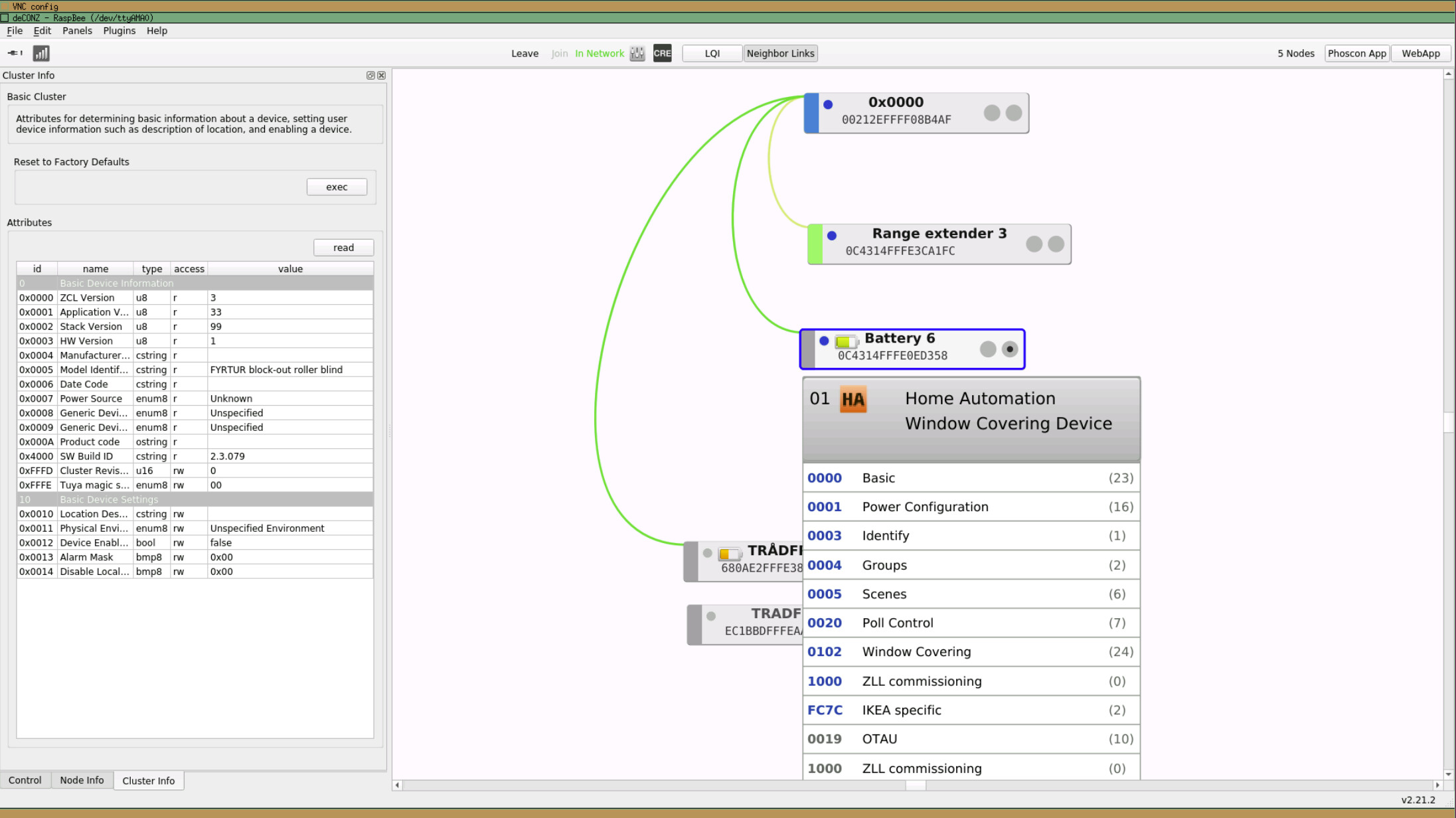

After selecting the “Battery 5” device, the “Basic Cluster”, in the “Clsuter info” can you click on “read” button and after that Ctrl+E and “preview” tab ?

Battery 5 is now Battery 6 - did again a factory reset to make the blind work again, it’s a WAF thing :smiley:
After pressing the READ Button

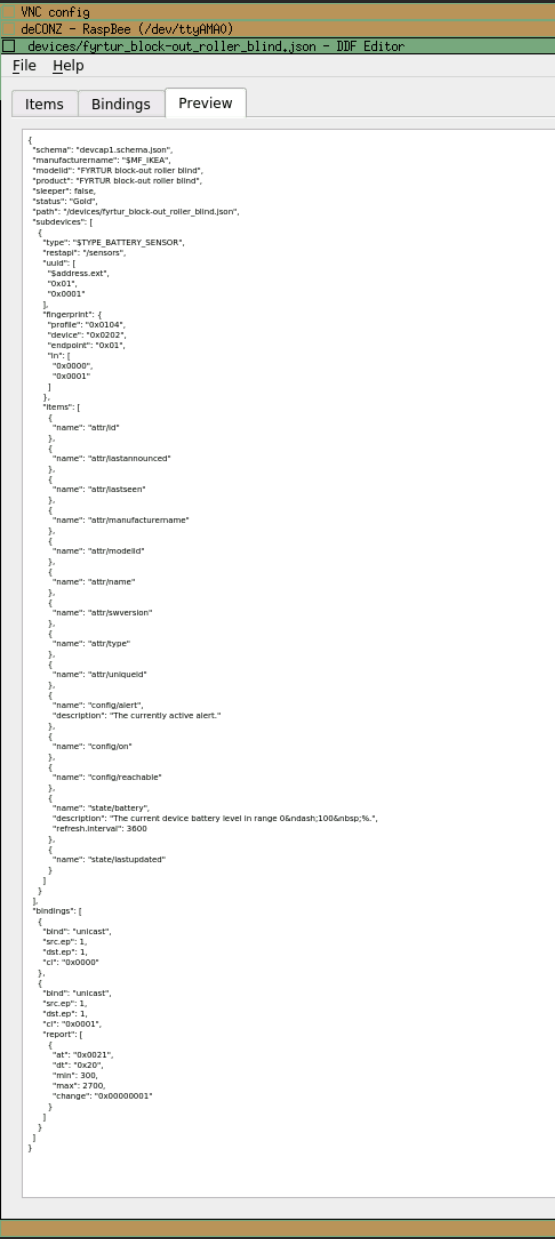

“Preview” Tab in the Edit DDF Window (I hope you can read everything)

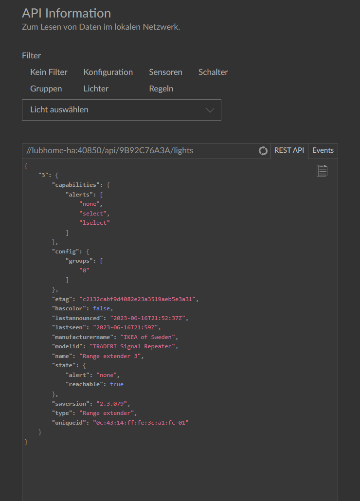

In light section I only have the range extender thing that came with the fyrtur blind.
But in the Sensor section it shows the “Battery 6”
There is something strange on the DDF displayed en the preview tab.
It’s the one from the disk, and not an autogenerated one, because the status is gold and it have a path, but this one is incomplete, the good one is deconz-rest-plugin/devices/ikea/fyrtur_block-out_roller_blind.json at master · dresden-elektronik/deconz-rest-plugin · GitHub
The path is not good (the good one is devices/ikea/… ), I think you have an old DDF file you need to remove on your disk.
