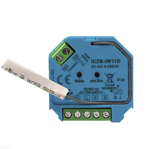

I’ve paired a iCasa ZB Dimmer and although it’s working fine, it’s showing a lot of errors in the debug log:

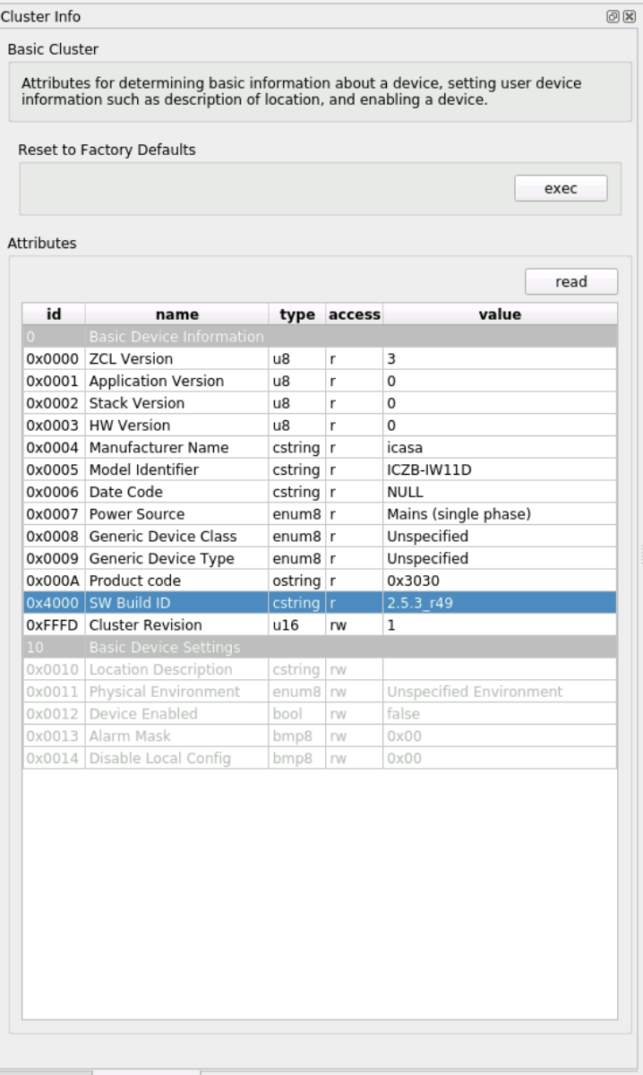

In the DDF the swversion is set to:
ZCL
Endpoint: 255
Cluster ID: 0x0000
Attribute ID: 0x4000
Expression: Item.val = Attr.val
In the debug view → ZCL it shows a couple of errors: got unsupported status: 0x86 for mandatory attribute which show in between the ZLC read attr for that device.
