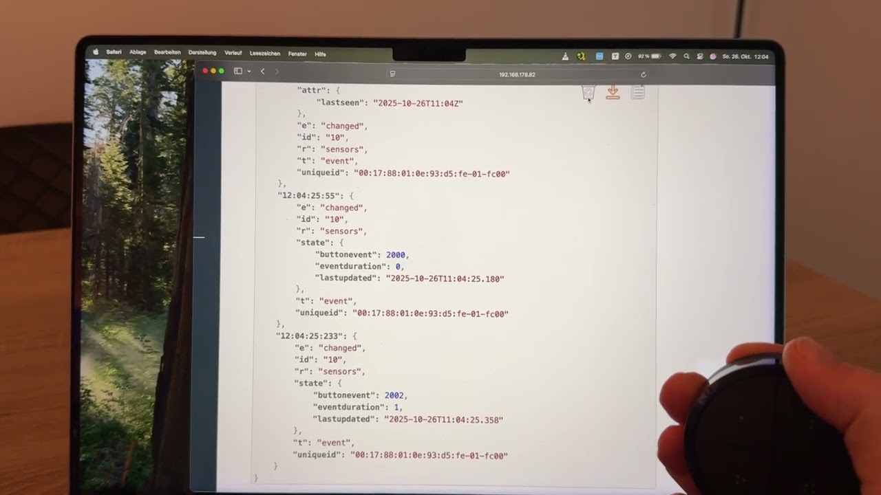

When debugging with the Rest-API in the Phoscon App, I can see that every button press from the tap dial switch is recognized, but the rotary events are just like coincidence that phoscon recognize the event.

Thanks for the info. We will do some tests with the switch and check what the problem could be.
So we found some problems with the switch editor and the created rules for the hue tap dial and will fix it soon.
