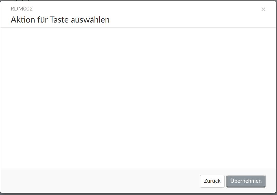

a Hue Tap Dial (RDM002) could be added and the 4 buttons in the middle can be configured with an action. But after selecting one of the two dial directions the following screen is empty.
Gateway version is 2.30.2.

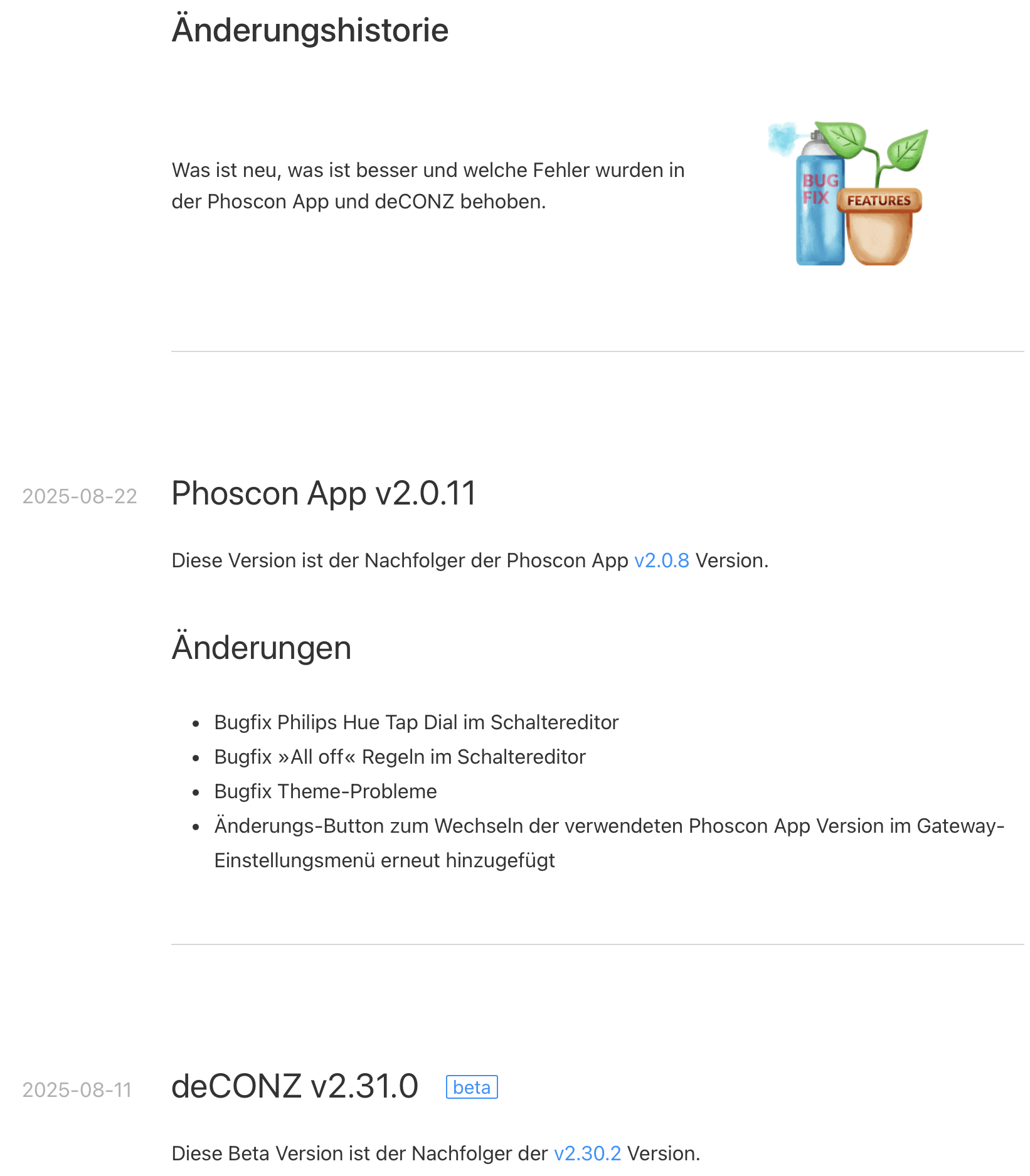

Yes the fix is already in our newest Phoscon App to which we added a new Dashboard front page.
Our deCONZ developer needs some more time to integrate it to the deCONZ installer so for now it is only available for smartphone from the android or iOS store or as a manual download and copy from our server so that you can use it in your browser. I just copy here a how to install, that I wrote in another post:
For now you can download the new Dashboard version for deCONZ to use in your browser on a PC from here: Index of /phoscon_app/
Just extract the newest archive from there to your deCONZ installation directory.
usually in your AppData directory:
C:\Users…\AppData\Local\Programs\deCONZ\bin\plugins\de_web\pwa
Delete the old content in the pwa folder and extract all files into that folder.
Then you have the newest version when you open the app with your PC’s IP in your browser.
Until you install a new deCONZ version. Then it is overwritten. But in one of the next deCONZ beta versions there will be the ne App integrated.
