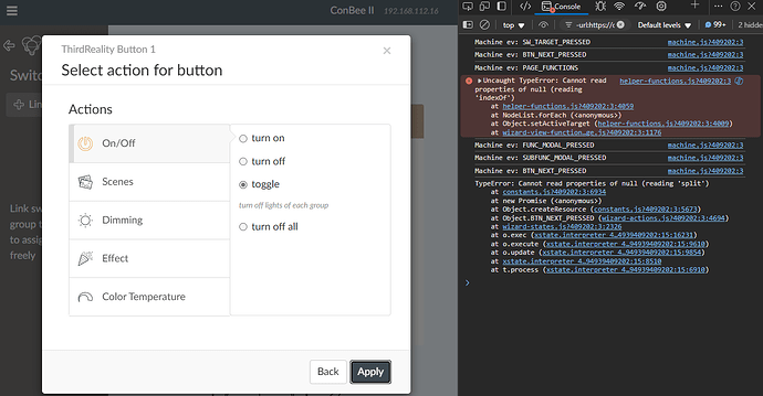

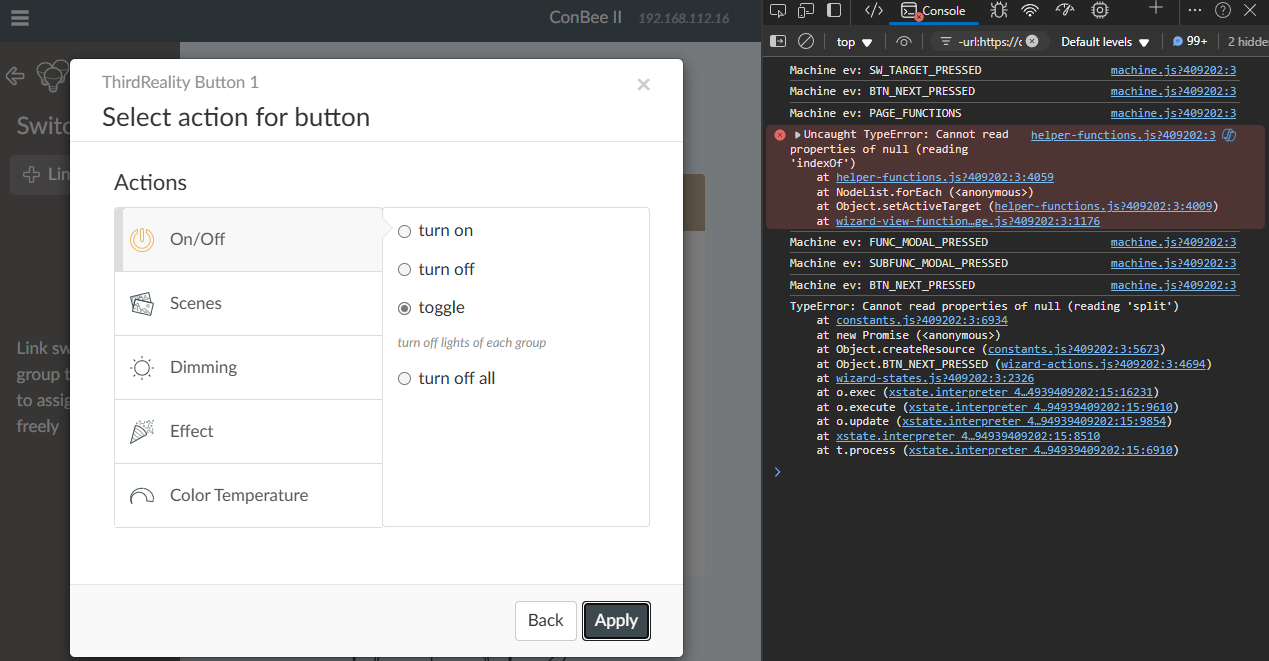

I think I am experiencing the same bug, for another switch device (ThirdReality Smart Button added in Third Reality, Inc. Smart Button 3RSB22BZ · Issue #7863 · dresden-elektronik/deconz-rest-plugin · GitHub).
On the first selection of the button, I see a browser console error, then another error when trying to save the action.
Similar to the original poster, I can also add other switch actions with no issue for an Ikea Tradfri and Styrbar remote.
