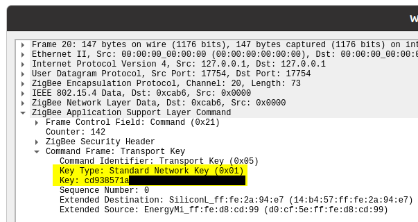

How to read the transport key
He,
is it posible to read the transport key of a deConz/Phoscon configuration and how do it?
Hello, you have it in the setting panel in deconz.
There is only the network key, no transport key found on settings panel…
must be 32 byte … There are only 16 byte on the panel
Hu I can be wrong, but you are sure you need the good key ?
The request is called “transport key” and use the network key.
And 0x22 is 2 bytes, a bytes is 1 octet = 8 bits and is from 0 to F.
