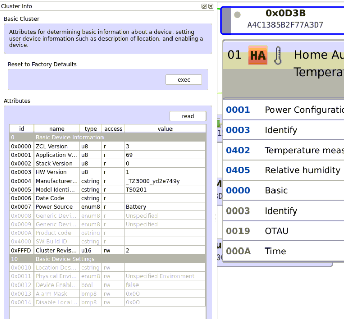

I got the below sensors as they said they are Zigbee, and also compatible with Tuya and Alexa so I assumed they’d pair with Conbee. Looks like they are pairing in Conbee/deCONZ but they don’t show up in Phoscon? when I open the node info models say TS0201 & TS0601
I’m new to all of this so it seems I need DDFs? Where can I get these and where to put them?
Screenshots attached – help is highly appreciated!

They seem to be unsupported.
What is their manufacturer name?
Open The basic cluster and click read (might need to be awake).

I tried the DDFs posted for both devices… they do pair/show in deCONZ but are not “publishing” (or whatever the correct term is) so the devices do not show in Phoscon or Homeseer. I have 17 other sensors and 15 lights which all work fine, multiple brands.
I’m having the same issue both of these…

other stock DDFs are in that folder - my added DDFs are getting “attached” to the new paired devices from within the deCONZ app. So looks like deCONZ recognizes those DDFs belong to the new devices.
But, still not showing in Phoscon?
