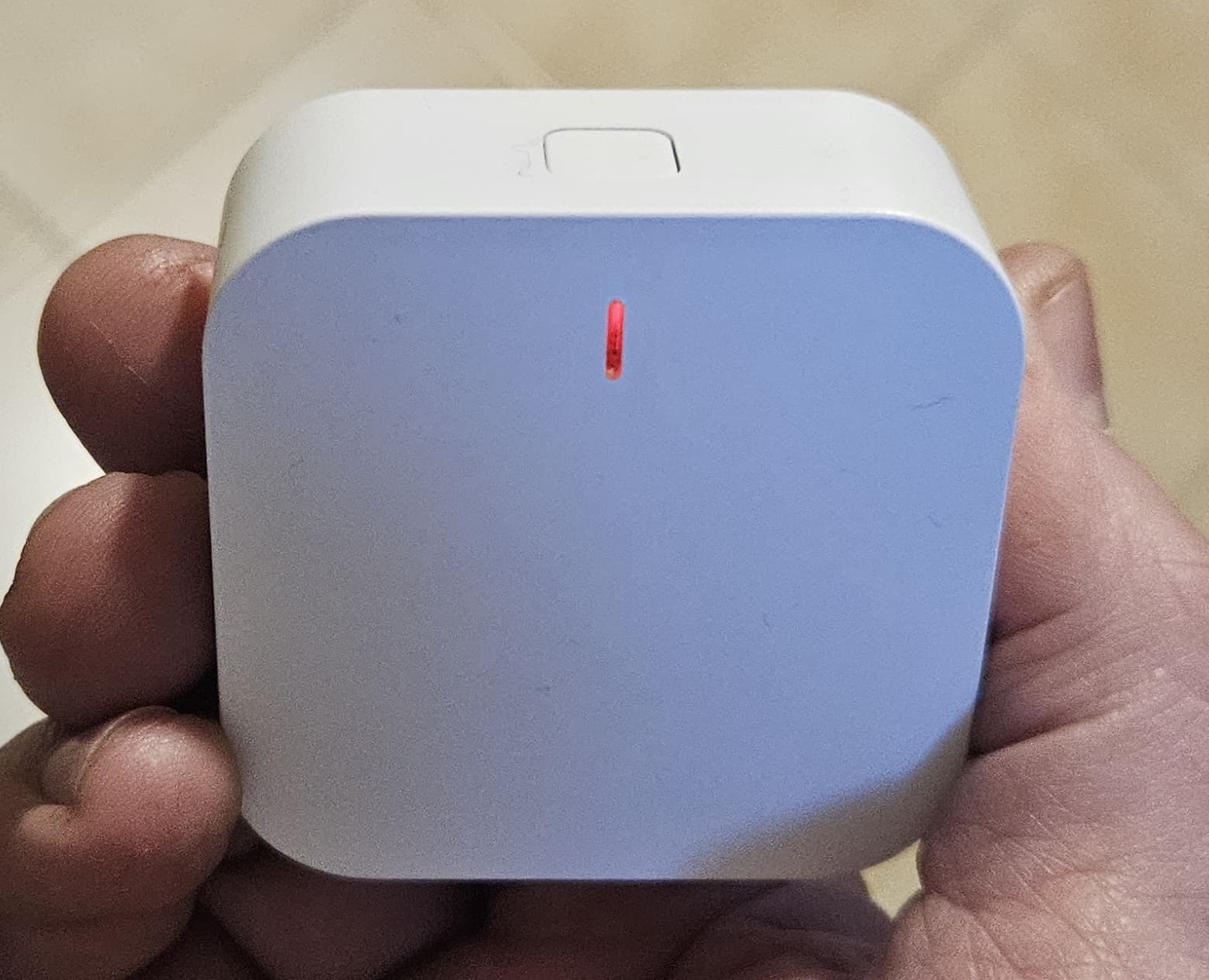

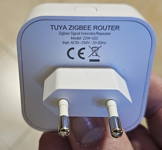

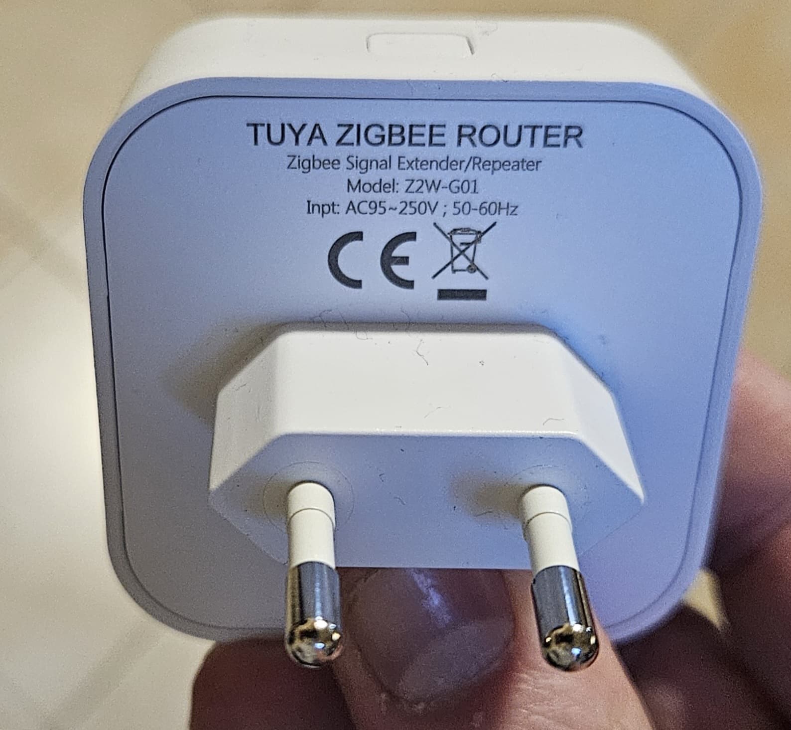

It is the Z2W-G01
Using deCONZ on a Raspberry Pi4 8GB…
Trying the web app to pair leaves the device with a Blue+Red light but I don’t see my far devices connected.
It is the Z2W-G01

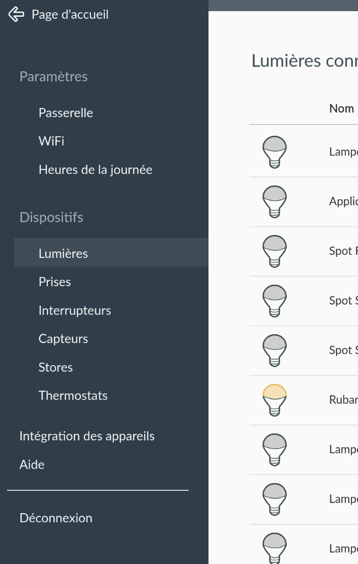

I’m not sure the repeater is on deCONZ.
There is no way to search.
I don’t know what to do to pair it, it’s not a lamp, a switch, a sensor, I tried them all.
It’s a lamp, but “other devices procedure” will work too.
You can do like you want, in reality there is only 1 “permit join” request in API, and it work for "light’ and “sensors”.
It’s just cosmetic.

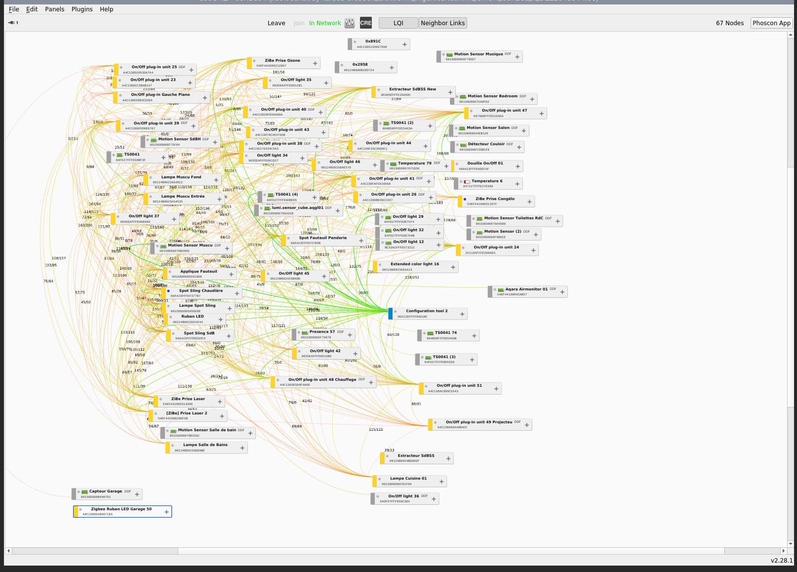

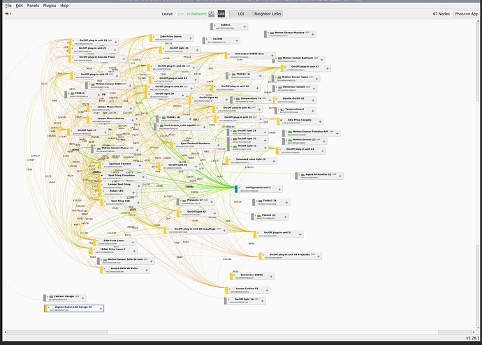

And your capture, all device are online.
When they are offline, the name will be grayed
Name like 0xXXXX mean “not included in API”
Can take a look too on “on-off plugin Unit X” and take the bigger number.
