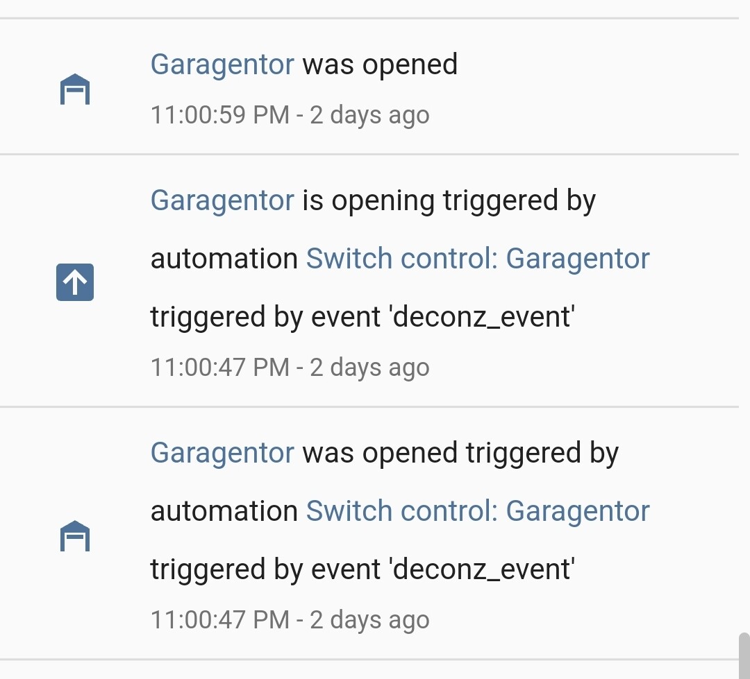

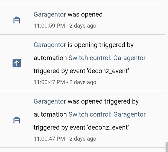

Dear both, thanks for spending time on this.
I think it would be quite surprising if HA would be the issue. The events do appear in the HA recorder function exactly like a deconz event. But let’s find out.
This is a bit mysterious issue - maybe it is an artifact of the upgrade in some way. Since the smart buttons do not really have a critical function in my setup, I will do some more experiments and report back.
And just by curisosity, there is a logic in the event ? Like always the same button or the same event, or always the same butonevent than the previous one ?
I could observe the issue with all buttons which are currently in use (four of them). The emitted events correspond to the last event triggered by a button press - in most cases this is 1002, but in one case (said garage) it is 1004, double click. For each button, the same event was emitted several times in a fixed interval (approx. 50 min).
Restarting deconz did not resolve the issue which is curious.

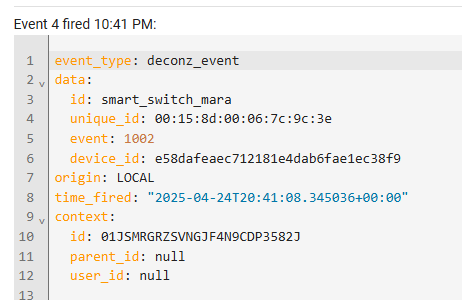

[EDIT 2] I could now catch it - nobody did press this button.
    "22:41:08:623": {
        "attr": {
            "ddf_hash": null,
            "ddf_policy": "latest_prefer_stable",
            "lastannounced": null,
            "lastseen": "2025-04-24T20:41Z",
            "manufacturername": "LUMI",
            "mode": 1,
            "modelid": "lumi.remote.b1acn01",
            "name": "Smart Switch Mara",
            "nwkaddress": 62791,
            "swversion": "20180525",
            "type": "ZHASwitch",
            "uniqueid": "00:15:8d:00:06:7c:9c:3e-01-0012"
        "e": "changed",
        "id": "98",
        "r": "sensors",
        "t": "event",
    "22:41:08:671": {
        "capabilities": {
            "sleeper": true
        "e": "changed",
        "id": "98",
        "r": "sensors",
        "t": "event",
    "22:41:08:673": {
            "battery": 100,
            "reachable": true,
            "temperature": 2500
        "e": "changed",
        "id": "98",
        "r": "sensors",
        "t": "event",
    "22:41:08:674": {
        "e": "changed",
        "id": "98",
        "r": "sensors",
            "buttonevent": 1002,
            "lastupdated": "2025-04-07T22:41:38.287"
        "t": "event",
Corresponding event in HA (which triggered an automation):
Good: I am not crazy. Will now try what happens if I install the DDF.
