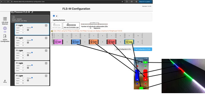

To demonstrate, I have tested two approaches in the Config-Builder. The first uses individual lights at odd positions (e.g., 1, 3, 5, 7, 9), achieving pure RGB separation without WW/CW activation, as shown in the attached “Odd Segments Configuration - Pure RGB” (screenshot and output).

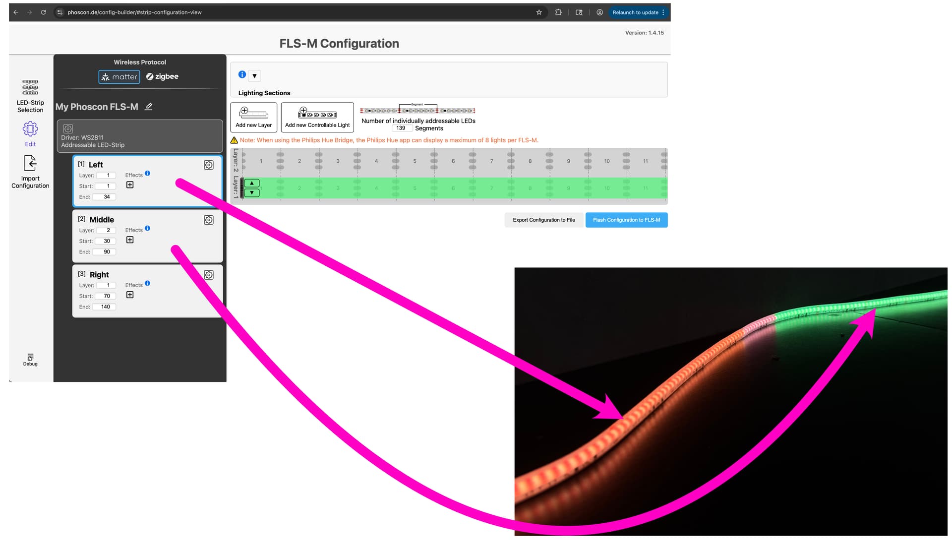

In contrast, continuous segments (e.g., Layer 1: 1-34 green; Layer 2: 30-90; Layer 1: 70-139 orange/green) result in unintended WW/CW illumination, visible as white interference in the gradient, per the attached “Continuous Segments Configuration - With WW/CW Interference” (screenshot and output).

Currently we support a maximum of five color channels R, G, B, WW, CW, but your LED stripe has 2 ICs with 3 color values for each segment. We have to build in a “blank” channel.
A solution would be included in the upcoming firmware update.
