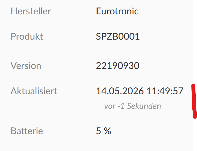

Since updating deCONZ from v2.31.2 to v2.32.5 on 2026-05-08 (via HA deCONZ addon update v8.5.2 to v8.7.0), I see two issues for the SPZB0001:
  1. Constant device updates according to Phoscon, literally every second (probably multiple times) as reported in this thread
This squeezed the batteries quite a lot in those few days (not even a week), now they’re almost empty at 5 % for one device.

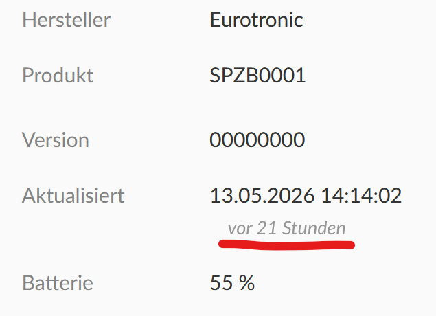

2) Complete loss of connection which sometimes returns after a few hours, sometimes never comes back - so the very opposite of issue #1

Update 1: DDF loaded (NOT working via the device integration tab in Phoscon as it does not allow .json files by the way so I had to go the long way).
  • :red_question_mark:Issue #2 needs to be monitored for next few hours and days.
  • :warning: Issue #1 seems to be fixed for device 1, but not for device 2
    (device 1 looking good / better)
    (device 2 still constantly updating every second)
I checked in deCONZ both devices are using the updated DDF. Something’s still broken…

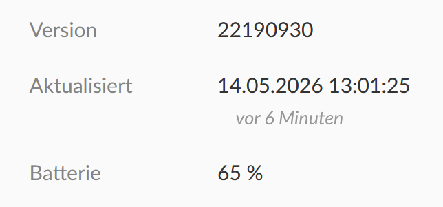

Update 2: After removing device 2’s batteries for a 2nd time and reloading Phoscon page, it seems to work properly for device 2 regarding issue 1.
Now monitoring the connection loss issue.
I just copied the json file into the folder /usr/share/deCONZ/devices/eurotronic and restarted deconz.
Since then, everything is running stable, also connection losses are gone and battery drain recovered.
Using this for 12 Eurotronic Spirit devices since a month now.
