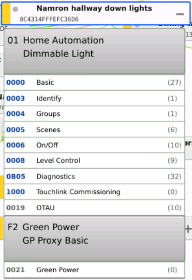

These are the 2 switch types I have installed:
You need to fire up the Deconz GUI and provide the clusters exposed by the device.
Unsure if a device can be both a light and a switch …
Also I can not find a DDF for 1402769 in the repository, so the first step to make one is have a look at those exposed clusters.

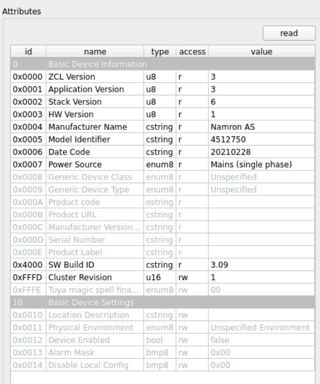

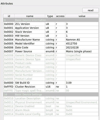

Deconz is very confusing to me, but maybe I have to learn to use it. Is this what you want to see?
Select the basic cluster and do a Read in the cluster info tab bottom left.
As suspected, there is no DDF…
Hi, from the screenshot you provided, I can conclude that this device does not have an OnOff/LevelControl client. It only has these clusters as a server (which is why the cluster numbers are blue). Servers accept commands, while clients emit commands.
This means the device cannot send control commands to other Zigbee devices but can likely only control itself.

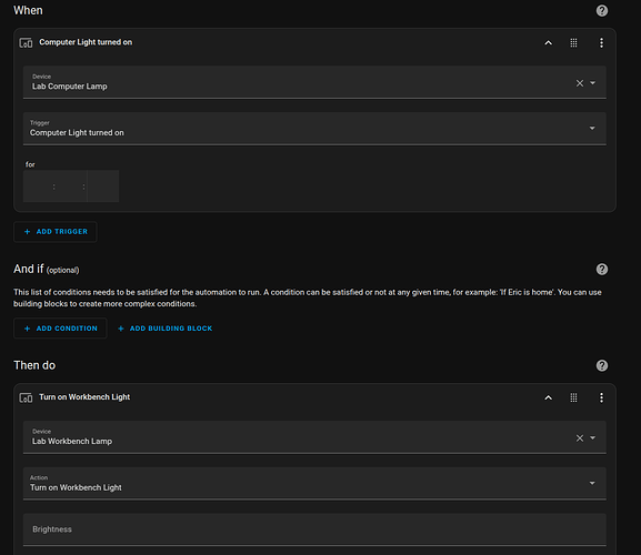

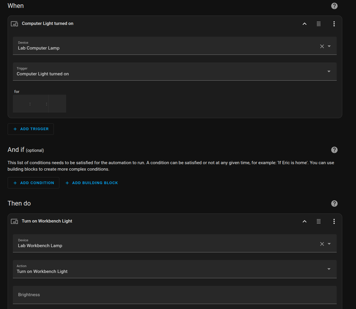

You could also try Home Assistant (with ZHA), as the ConBee is supported out of the box, and they provide an automation wizard for this.

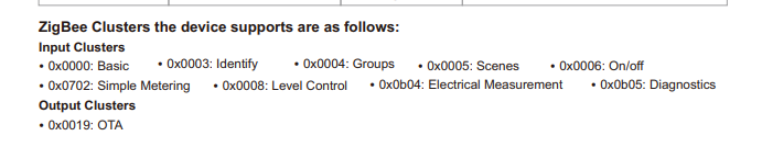

Didn’t know that color coding …
So these are the Input clusters found in the user manual.
Had there been any Output clusters, what color would they had been?
I also checked 2 Sunricher Rotary dimmers, and they had the exact same clusters, probably because Namron is a rebranded Sunricher.

Input clusters are blue.
Ouput clusters are grey.
Generaly wired switches are routers, and have only input clusters, so can only receive order > light
Battery switches are end device, have ouput cluster, can only send order > sensor
