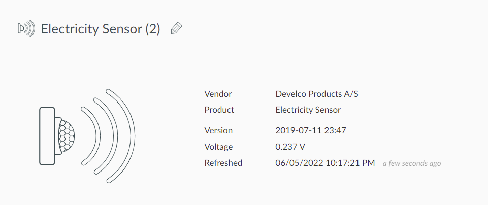

I have a Develco Norwegian Han sensor of type EMIZB-132 which now for sometime has been listed as not reachable in the Phoscon App. This status comes and goes and it was last reachable on 29/5. I have had this unit for over a year and not detected this status for this unit before the last month. The unit provides two sensors readings “power/consumption” and “voltage/phase current”, which is sent to my Home Assistant. It is the power/consumption sensor that is no longer reported correctly, while the voltage/phase current information is.
As mention the sensor is listed as “not reachable”, but cliking on it is show live info about the voltage level. So I am somewhat puzzeled why it is not reachable.
As a work around I am getting needed info via the API interface as this is still reporting the sensor information I need (see below from the API output from this sensor), so the unit is very much alive and doing its job.
I have tried the obvious things I think for getting it back; Restarted the gateway, triggered the sensor on the push button, but have not managed to get any status change. The sensor is quite close to the gateway and has a strong signal.
I am using version: 2.15.03 of the app and firmware 26680700 on my Conbee II
Is there other methods of getting this unit to work correcty again without reintegrate the device?

That behavior should be corrected with Fix setting lastannounced and sensor reachable by manup · Pull Request #6106 · dresden-elektronik/deconz-rest-plugin · GitHub and part of the upcoming version.
