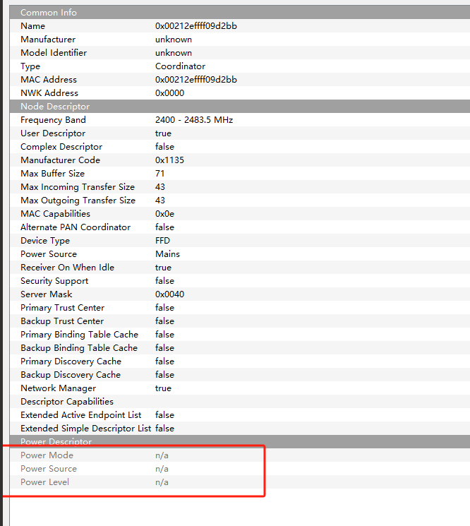

I check the user manual it doesn’t mention, and the node infor of power descriptor doesn’t show any data .
Checking device information of device detail ,it is up to 30 m (100ft) in buildings, then what it is default transmission power.

Yes , but I see it is max transmission power,not default power , is it mean this is default power setting?
Yes. I have no reason to not be like that.
Transmit power is not adjustable on any ConBee or RaspBee device, as this would violate regulatory restrictions for consumer devices sold in the EU.
Edit: It is fixed at 10dBm
