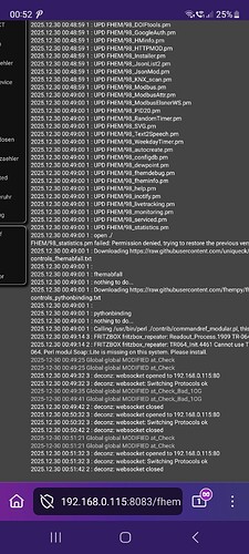

I’ve noticed that after the beta update, the WebSocket connection in FHEM is dropping, causing events to arrive 40 seconds late. Before the update, it was real-time. It’s real-time in the Phoscon app. I’ve also specified the WebSocket port in the FHEM configuration. But I haven’t changed anything in FHEM since it was working before.

I’m running version 2.32.2 Beta.
