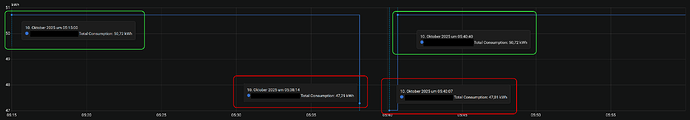

deCONZ sends rubbish "current summation delivered" for TS0121 + TS011F during deCONZ restart
When deCONZ restarts, deCONZ sometimes sends rubbish values

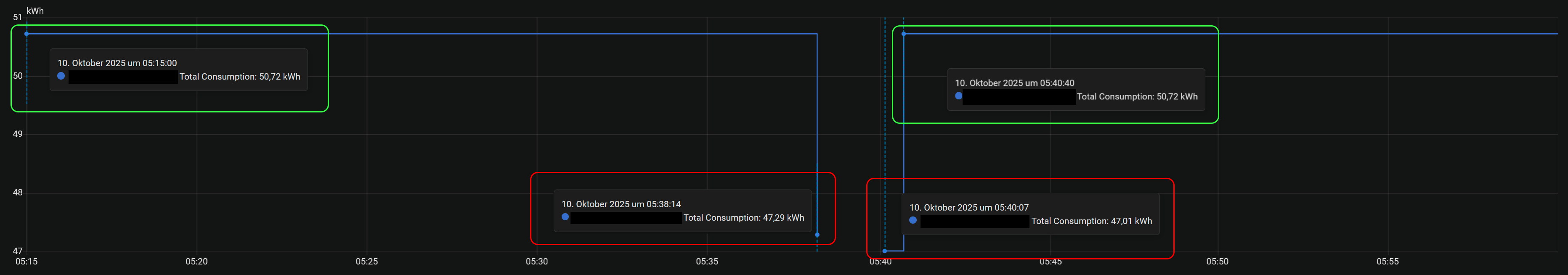

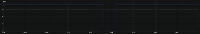

Example visualization for one device during one incident:
This has a massive impact on applications and data relying on those information. Details with more screenshots can be found at

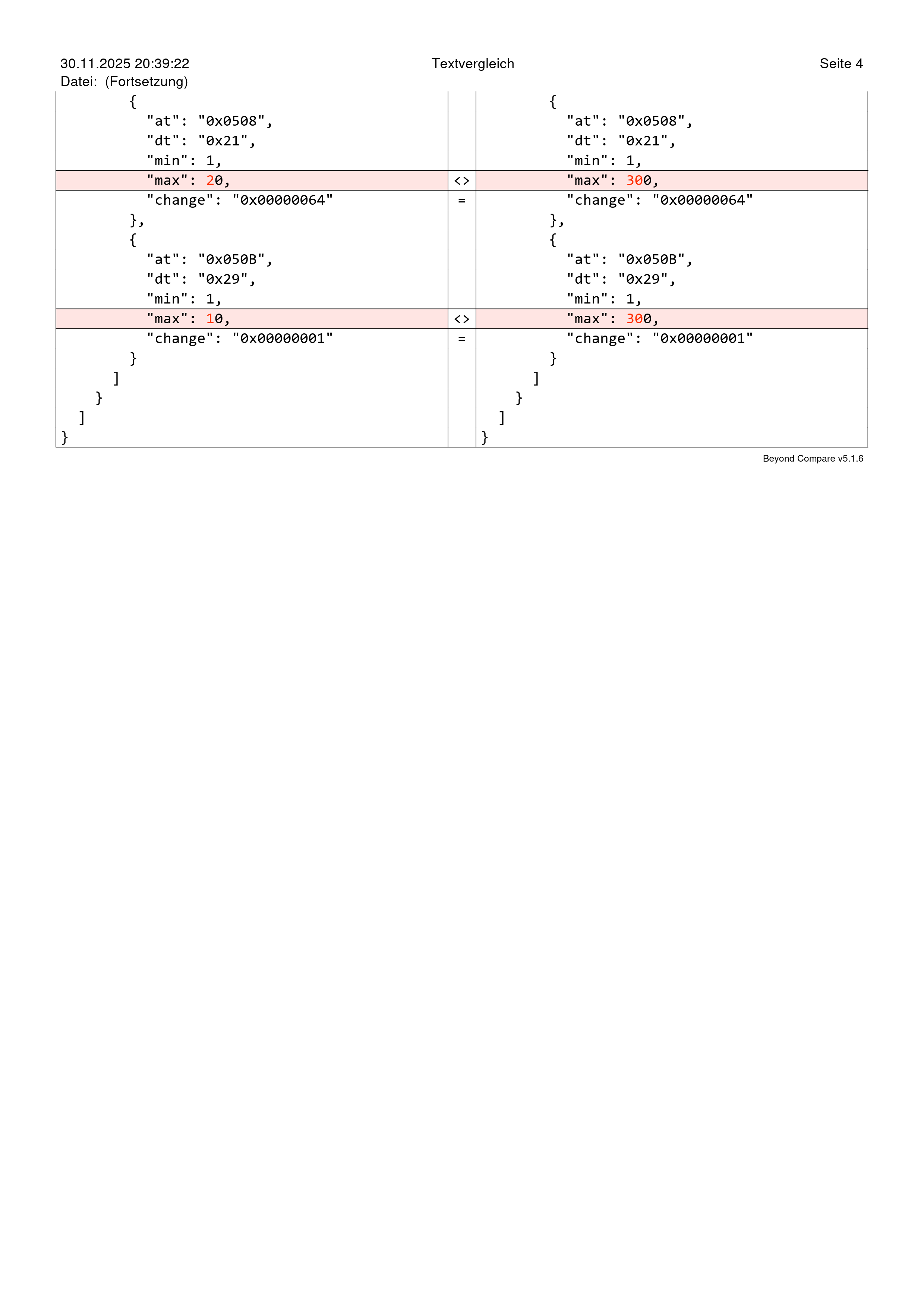

DDF for TS011F
Stock = same as deconz-rest-plugin/devices/lidl/hg08673.json at master · dresden-elektronik/deconz-rest-plugin · GitHub
Additionally:

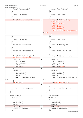

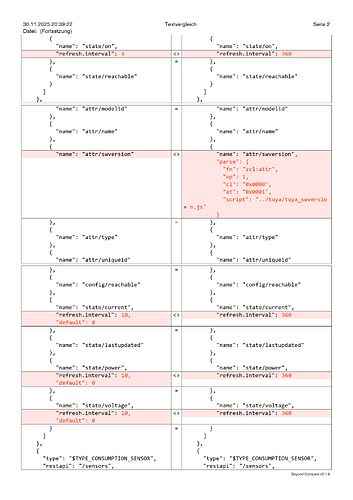

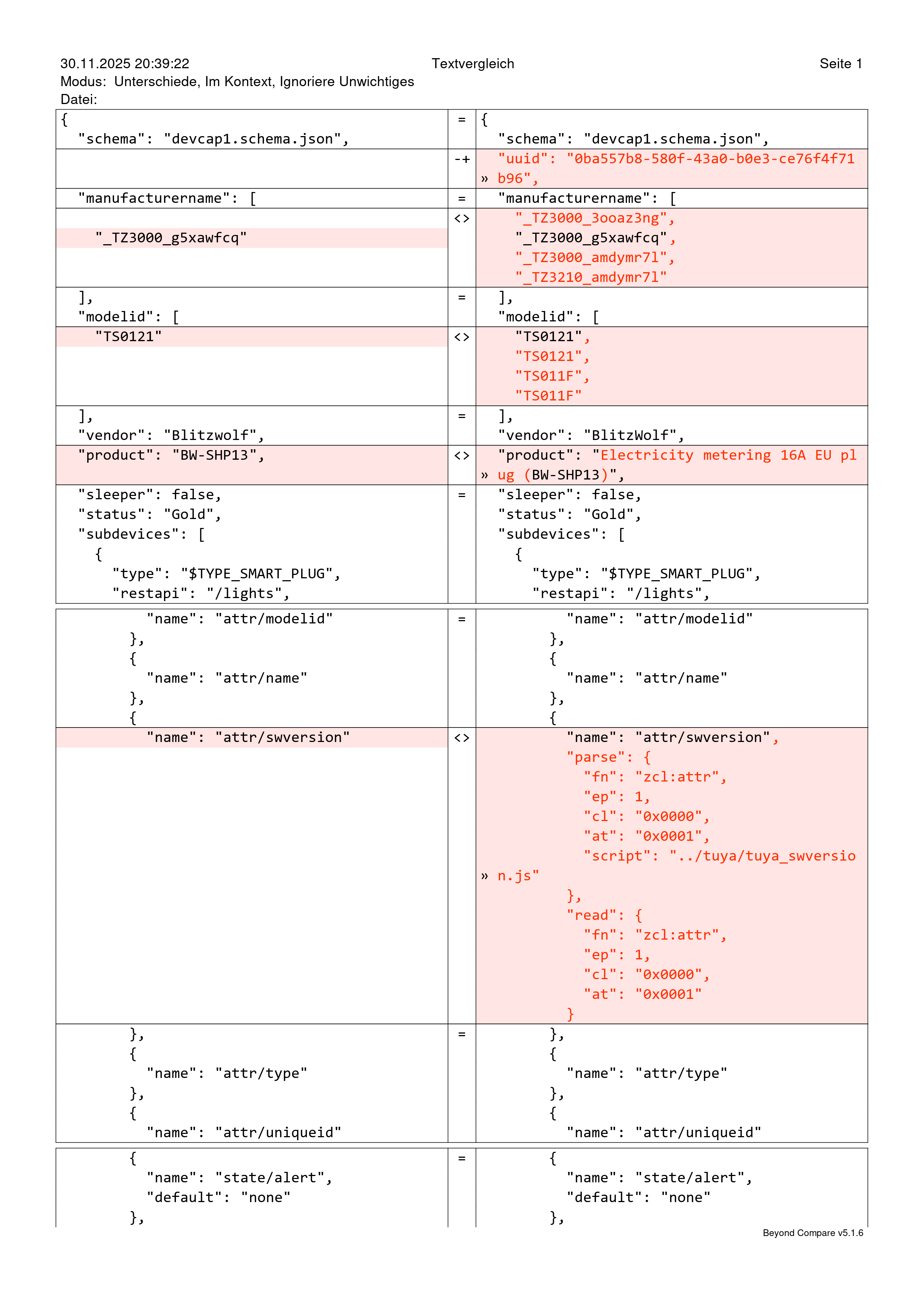

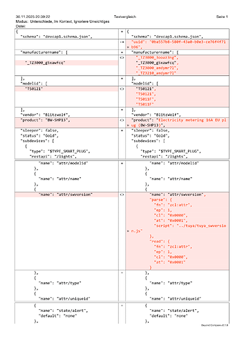

Comparison of current custom DDF for TS0121 (left) and GitHub https://github.com/dresden-elektronik/deconz-rest-plugin/blob/master/devices/blitzwolf/bw_shp13_smart_plug.json (right):
First questions:
1. How to proceed here? Raise an incident on the deCONZ GitHub repo?
2. Which information might be necessary (DDF or similar)? Edit: DDFs attached above
Please assist as this is massively bothering data integrity related to energy consumption calculation and statistics.
But I don’t see problems, the API just reflect the value send by the device no ?
I can understand if deconz send a 0 value at start, but a “random” value …
You have an idea what is this value ? It’s always the same
You have others plugs without this issue ?
I don’t see similar issue on google for this kind of device, and hard to catch logs if this happen only during the deconz start …
As work around, it’s possible to update the value only if this one is superior the previous one, but will be a problem if you try to reset the device.
Hi Smanar, great to see you around again.
No it’s not always the same value. You can see one example in the screenshot above (OP). The differences are completely different from case to case, sometimes „only“ 3 kWh, sometimes 121 kWh etc.
All plugs of those two device types are affected. All other power plugs integrated with deCONZ work fine, even I think they don‘t do power measurements but switching only.
That „only increase, never decrease the value“ workaround sounds interesting enough, worth to test. The values of those devices usually never reset (unlike Shelly on power outage) so it should be fine. How would I implement this? The DDF needs to be rock solid, I can test it productively on the upcoming restarts (manually).

But it’s strange I don’t see more this issue. On your picture we can see 2 good values and 2 bads, when the deconz restart was happen ?
