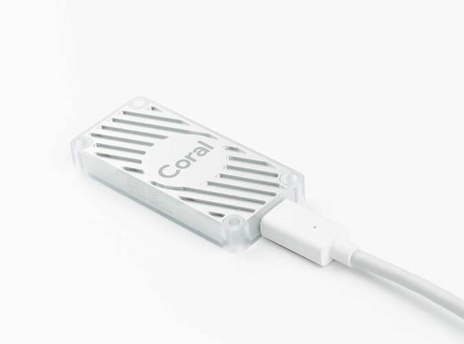

just curious about that, the coral already comes with an extension and i use that one already:
Does the lenght of the cable has any influence, because the coral cable is ca. 20 cm long?

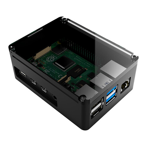

About your Pi: What casing is it in? Is it metal perhaps? Are you using WifI or bluetooth?
Hi Dennis,
it is this case, so yes, it is aluminium:
I am using an Ethernet-cable on the pi but i am not sure if Wifi is turned off. I will have a look in the config.txt later. Bluetooth is surely off. I bought a 3 m extionsion cable now and i am trying it with the Google Coral far away. I changed my Zigbee-Channel to 25 instead of 11 (it changed to 15 sometimes without doing something tho). If none of that works now i am out of ideas.
Maybe a plastic housing as the last approach but they are ugly af…^^ or you can make a good deal on a Conbee II and i put that on an extension cable.
Cheers,
Philipp
Hi Philipp,
I think that’s the issue here: The case. What happens if you take it out? Does it work then?

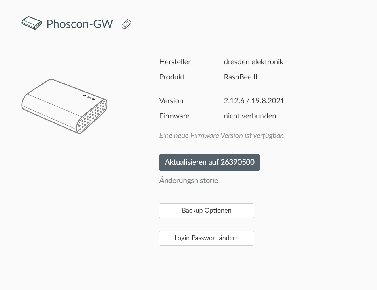

i saw now that the Zigbee-Channel switched from 25 to 11 again, i setted it again to 25 and edited the config.txt to disable wifi. After rebooting the raspbee cannot connect to the network anymore. In phoscon it shows firmware not connected.
I made a log file:
I reached the end of my knowledge. There is no device on the USB-Port at the moment and the Pi is without the case now. Is there a way to factory reset the raspbee and start from scratch?

Thats it. So lucky me, not a single 0xE1, without the Coral. So, if the Raspbee is working while the Coral is on a long Extension Cable in the next run, that means i can keep my Aluminium Case or am i wrong?

So even after 12 hours of a reconnected Coral USB Accelerator on an 3 m Extension Cable i have not encountered a single 0xE1 Error. I will reevaluate this over the next weeks to be absolutely sure it was only the coral that caused the interferences. If i get a single 0xE1 in the next weeks i change the Aluminium-case as well. I hope this issue can be considered as closed so far.
For everyone reading this thread, the solution to this whole situation was the following:
  • unplugging the Google Coral as it caused 0xE1 Errors on the standard cable that gets shipped with it
  • if you use Home Assistant, prepare a second SD-Card (consider using ConBee II SD-Karten Images or use Raspian but be sure to install deConz before trying to flash)
  • manually updating and flashing of the firmware of the Raspbee as stated in the link below
  • https://github.com/dresden-elektronik/deconz-rest-plugin/wiki/Update-deCONZ-manually#update-in-raspbian
  • if the Flasher shows “retry, failed” ignore it and revert to Home Assistant, it worked despite of the message (should be fixed with the next GCFlasher version anyway).
  • reinstalling and positioning of the Google Coral on a 3 m Extension Cable away from the Raspberry Pi
