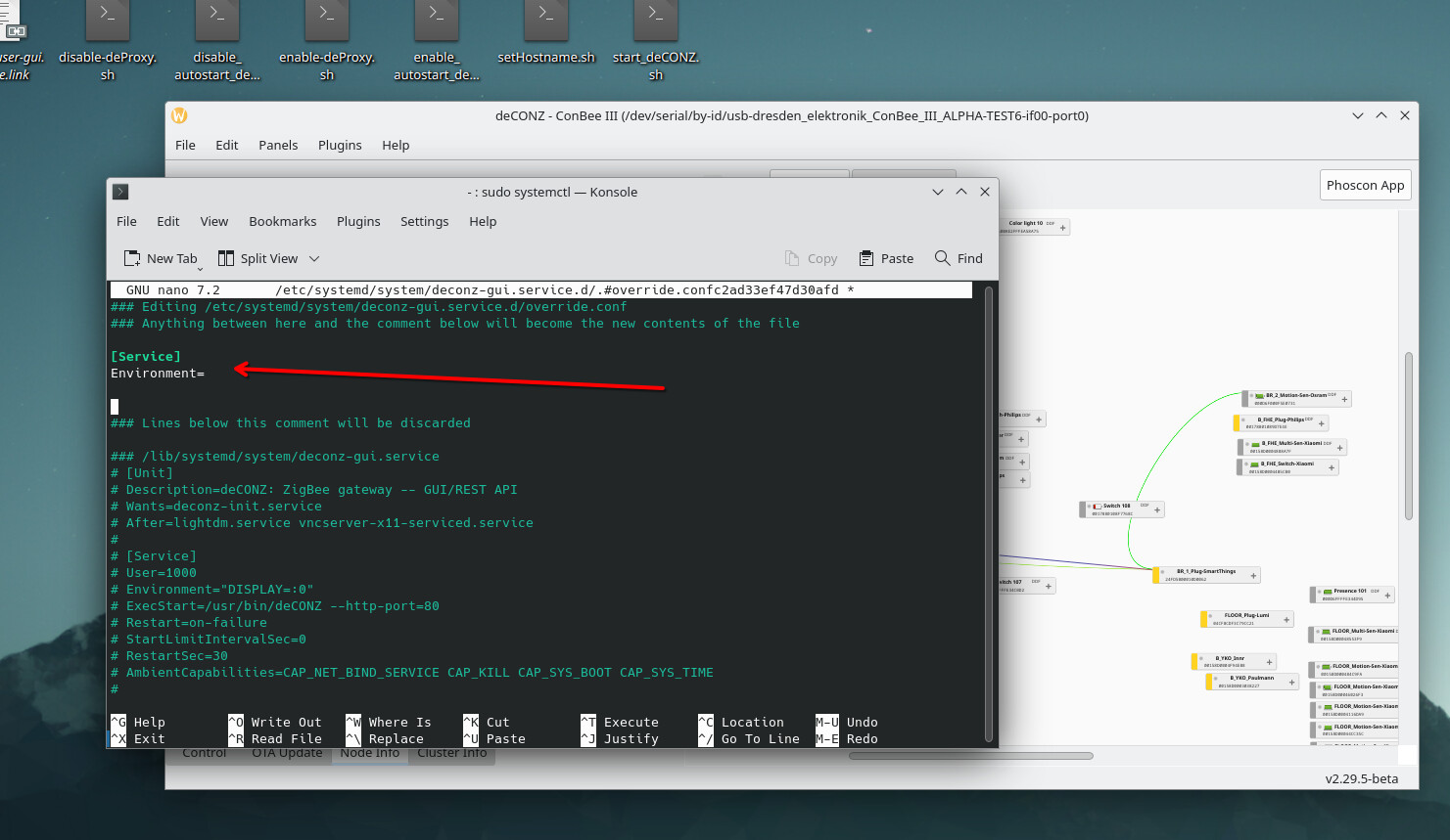

Describe the bug
deconz GUI will not start when run as a service sudo systemctl start deconz-gui but the GUI starts okay if I run /usr/bin/deCONZ from the same terminal.
Steps to reproduce the behavior
- Install Debian 12 GNOME on amd64 PC (I used Index of /debian-cd/current/amd64/iso-dvd)
- Follow instructions on ConBee II Installation to install deconz
- Enable auto login so the GUI can start
sudo systemctl enable deconz-guisudo systemctl disable deconz
I also changed the http-port to 8081 in the service file sudo systemctl edit deconz-gui
Expected behavior
Deconz should start and show GUI
Environment
- Host system: PC
- Running method: Debian 12
- Firmware version: 26720700
- deCONZ version: 2.22.02
- Device: ConBee II
- Do you use an USB extension cable: yes
- Is there any other USB or serial devices connected to the host system? If so: Which? Wireless mouse
deCONZ Logs
Aug 18 17:30:27 lm700 systemd[1]: deconz-gui.service: Scheduled restart job, restart counter is at 1.
Aug 18 17:30:27 lm700 systemd[1]: Stopped deconz-gui.service - deCONZ: ZigBee gateway -- GUI/REST API.
Aug 18 17:30:28 lm700 systemd[1]: Started deconz-gui.service - deCONZ: ZigBee gateway -- GUI/REST API.
Aug 18 17:30:28 lm700 systemd[1]: Starting deconz-init.service - deCONZ: ZigBee gateway -- Initialisation...
Aug 18 17:30:28 lm700 deCONZ-init.sh[31735]: cat: /sys/block/mmcblk0/device/cid: No such file or directory
Aug 18 17:30:28 lm700 deCONZ[31727]: Authorization required, but no authorization protocol specified
Aug 18 17:30:28 lm700 deCONZ[31727]: qt.qpa.xcb: could not connect to display :0
Aug 18 17:30:28 lm700 deCONZ[31727]: qt.qpa.plugin: Could not load the Qt platform plugin "xcb" in "" even though it was found.
Aug 18 17:30:28 lm700 deCONZ[31727]: This application failed to start because no Qt platform plugin could be initialized. Reinstalling the application may fix this problem.
Aug 18 17:30:28 lm700 deCONZ[31727]: Available platform plugins are: eglfs, linuxfb, minimal, minimalegl, offscreen, vnc, wayland-egl, wayland, wayland-xcomposite-egl, wayland-xcomposite-glx, xcb.
Aug 18 17:30:28 lm700 deCONZ-init.sh[31728]: stopping deconz-wifi.service
Aug 18 17:30:28 lm700 systemd[1]: deconz-gui.service: Main process exited, code=killed, status=6/ABRT
Aug 18 17:30:28 lm700 systemd[1]: deconz-gui.service: Failed with result 'signal'.
Aug 18 17:30:28 lm700 systemd[1]: Reloading.
Aug 18 17:30:28 lm700 systemd[1]: deconz-init.service: Deactivated successfully.
Aug 18 17:30:28 lm700 systemd[1]: Finished deconz-init.service - deCONZ: ZigBee gateway -- Initialisation.
