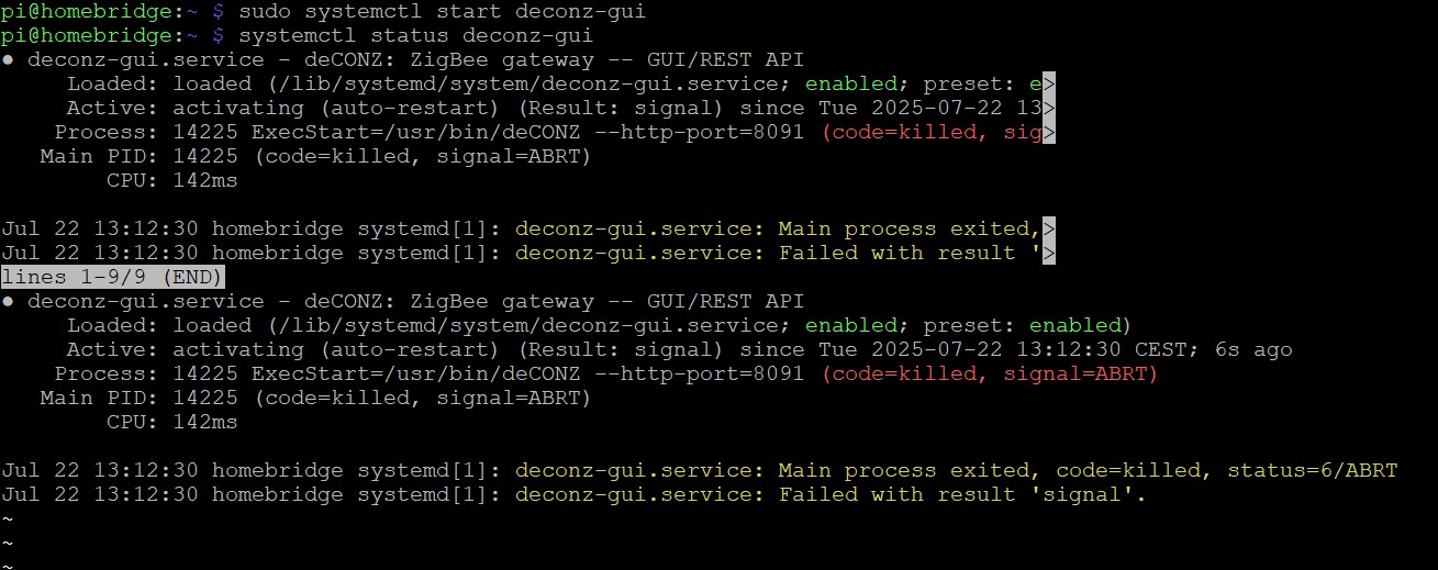

In the SSH session, when checking for deconz-gui “status” it says the following:
i@homebridge:~ $ sudo systemctl start deconz-gui
pi@homebridge:~ $ systemctl status deconz-gui
● deconz-gui.service - deCONZ: ZigBee gateway – GUI/REST API
Loaded: loaded (/lib/systemd/system/deconz-gui.service; disabled; preset: enabled)
Active: activating (auto-restart) (Result: signal) since Tue 2025-07-22 13:05:56 CEST; 4s ago
Process: 11264 ExecStart=/usr/bin/deCONZ --http-port=8091 (code=killed, signal=ABRT)
Main PID: 11264 (code=killed, signal=ABRT)
CPU: 172ms
Jul 22 13:05:56 homebridge deCONZ[11264]: qt.qpa.xcb: could not connect to display :0
Jul 22 13:05:56 homebridge deCONZ[11264]: qt.qpa.plugin: Could not load the Qt platform plugin “xcb” in >
Jul 22 13:05:56 homebridge deCONZ[11264]: This application failed to start because no Qt platform plugin>
Jul 22 13:05:56 homebridge deCONZ[11264]: Available platform plugins are: eglfs, linuxfb, minimal, minim>
Jul 22 13:05:56 homebridge systemd[1]: deconz-gui.service: Main process exited, code=killed, status=6/AB>
Jul 22 13:05:56 homebridge systemd[1]: deconz-gui.service: Failed with result ‘signal’.

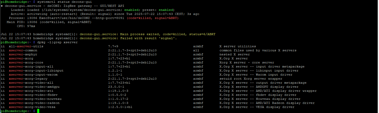

It seems the Xorg or Wayland session isn’t running.
Can you start other GUI applications like a GUI terminal?
Thanks for your reply.

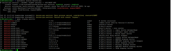

I installed xorg already. Do I need Wayland additionally?
What do you mean with GUI Terminal? I can boot into GUI and login, open network settings, or the GUI for VNC Server (even though it does not work either, but the GUI opens, for example.)
If you already have Xorg you don’t need to install Wayland.
What I meant is is the desktop environment running, e.g. seeing graphical widgets?
Usually from there you can launch deCONZ via the applications menu in Raspberry Pi OS manuall, while deconz and deconz-gui systemd services are stopped.
okay. Yes, Xorg is installed and desktop environment is running. I can see graphical widgets and open settings, help-menu, X11 VNC Server. Deconz Widget is visible, but nothing happens, after it is clicked.
