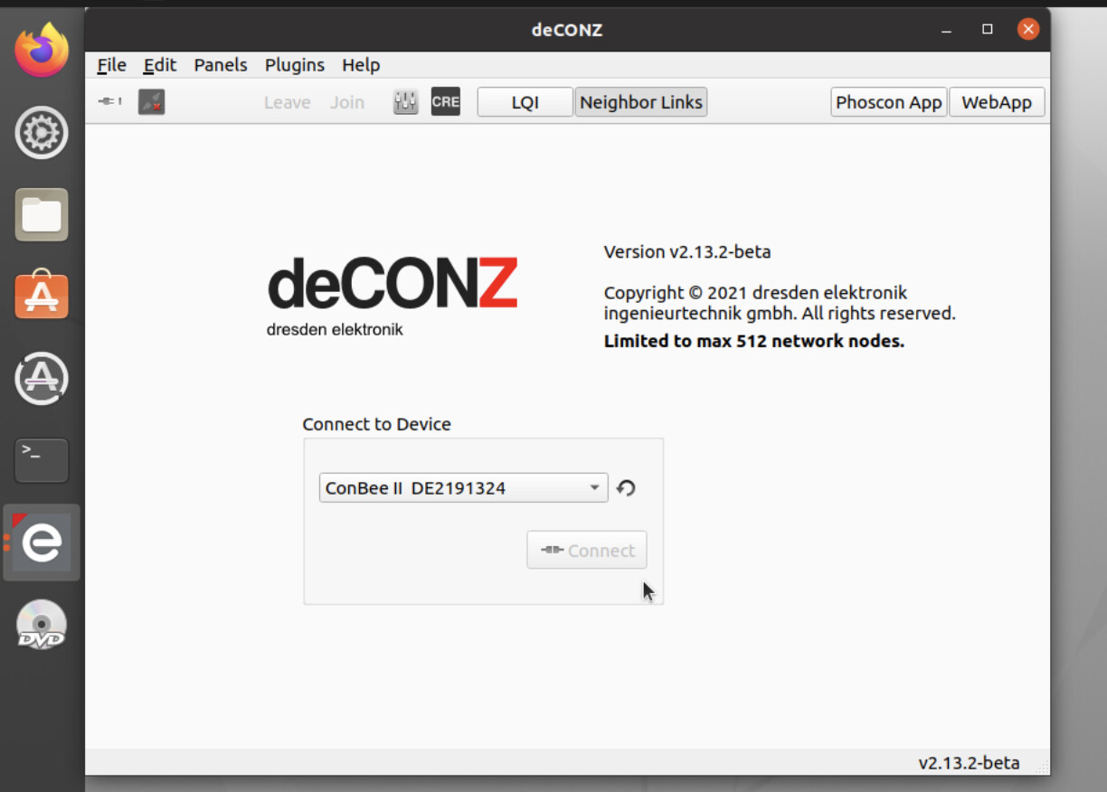

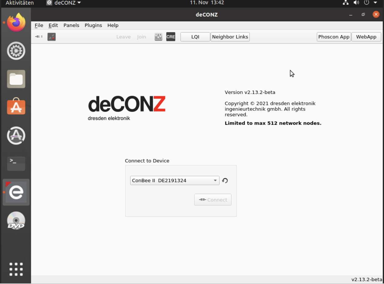

Please do not laugh, now I have the problem,
that I no longer see the signal page
Perhaps deconz is already running?
You cant have deconz and deconz-gui at the same time.
Unfortunately no - I have even now reinstalled the Deconz instance.
The same problem.
Can you share some logs?
New install - problem is ok :slight_smile:
