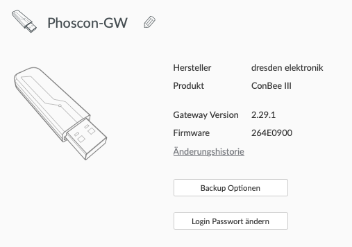

I cannot confirm that this problem is fixed with the newest firmware. I used:
ConBee III with deCONZ_ConBeeIII_0x264f0900.bin.GCF
deConz 2.25.1 installed on macOS
I’m using my old ConBee II at the moment, which works better in terms of batteries.
