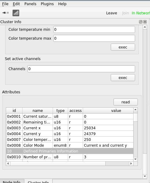

Hi there,
A proposal for Zemismart 3A125-15 led strip controller I currently used ([Zemismart Tuya Zigbee 3,0 Smart Streifen Licht Fahrer RGB RGBW LED Streifen Controller DC12V APP Control Kompatibel mit Smartthings|strip led|strip led remotestrip led 12v - AliExpress])
"manufacturername": "3A Smart Home DE",
"modelid": "LXT56-LS27LX1.7",
"vendor": "Zemismart",
"product": "3A12S-15",
"sleeper": false,
"status": "Silver",
"subdevices": [
"type": "$TYPE_EXTENDED_COLOR_LIGHT",
"restapi": "/lights",
"uuid": [
"$address.ext",
"0x01"
"name": "attr/id"
"name": "attr/lastannounced"
"name": "attr/name"
"name": "attr/swversion"
"name": "config/colorcapabilities",
"refresh.interval": 84000
"name": "config/ctmax",
"name": "config/ctmin",
"name": "state/alert",
"default": "none"
"name": "state/bri",
"refresh.interval": 5
"name": "state/colormode",
"name": "state/ct",
"name": "state/effect",
"default": "none"
"name": "state/hue",
"name": "state/on",
"name": "state/reachable"
"name": "state/sat",
"name": "state/x",
"name": "state/y",
"type": "$TYPE_ON_OFF_LIGHT",
"uuid": [
"$address.ext",
"0x01"
"name": "attr/id"
"name": "attr/name"
"name": "state/on",
"bindings": [
"cl": "0x0008",
"at": "0x0000",
"dt": "0x20",
"min": 10,
"max": 360
"cl": "0x0300",
"at": "0x0008",
"dt": "0x30",
"min": 10,
"max": 300
"cl": "0x0006",
"at": "0x0000",
"dt": "0x10",
"min": 5,
"max": 300
