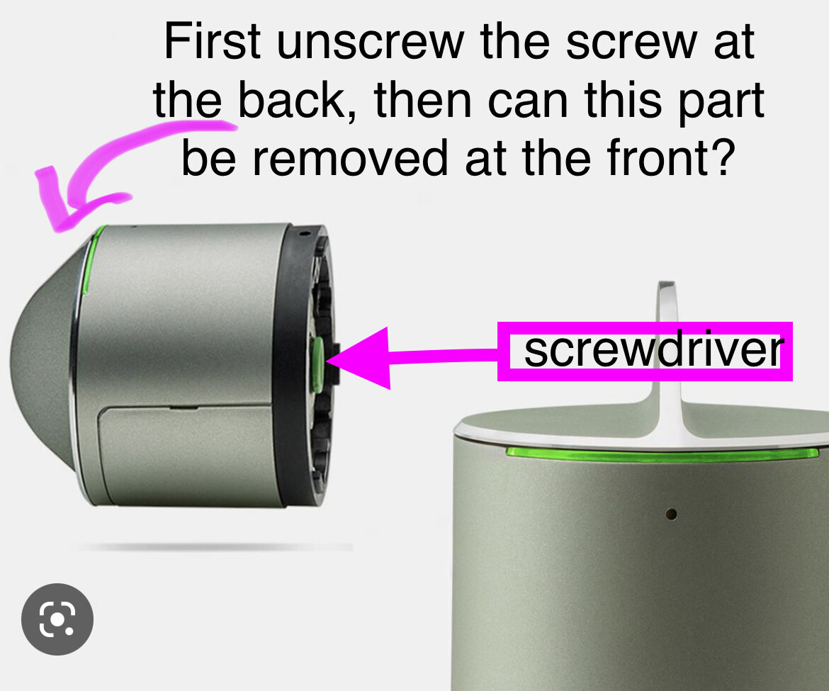

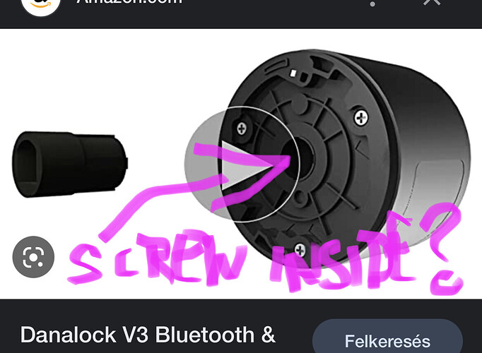

How securely is the lock assembled? If I glue the screws in the back so that they can’t be unscrewed, can the front rotating part be removed? How exactly is the lock assembled? Does anyone know?

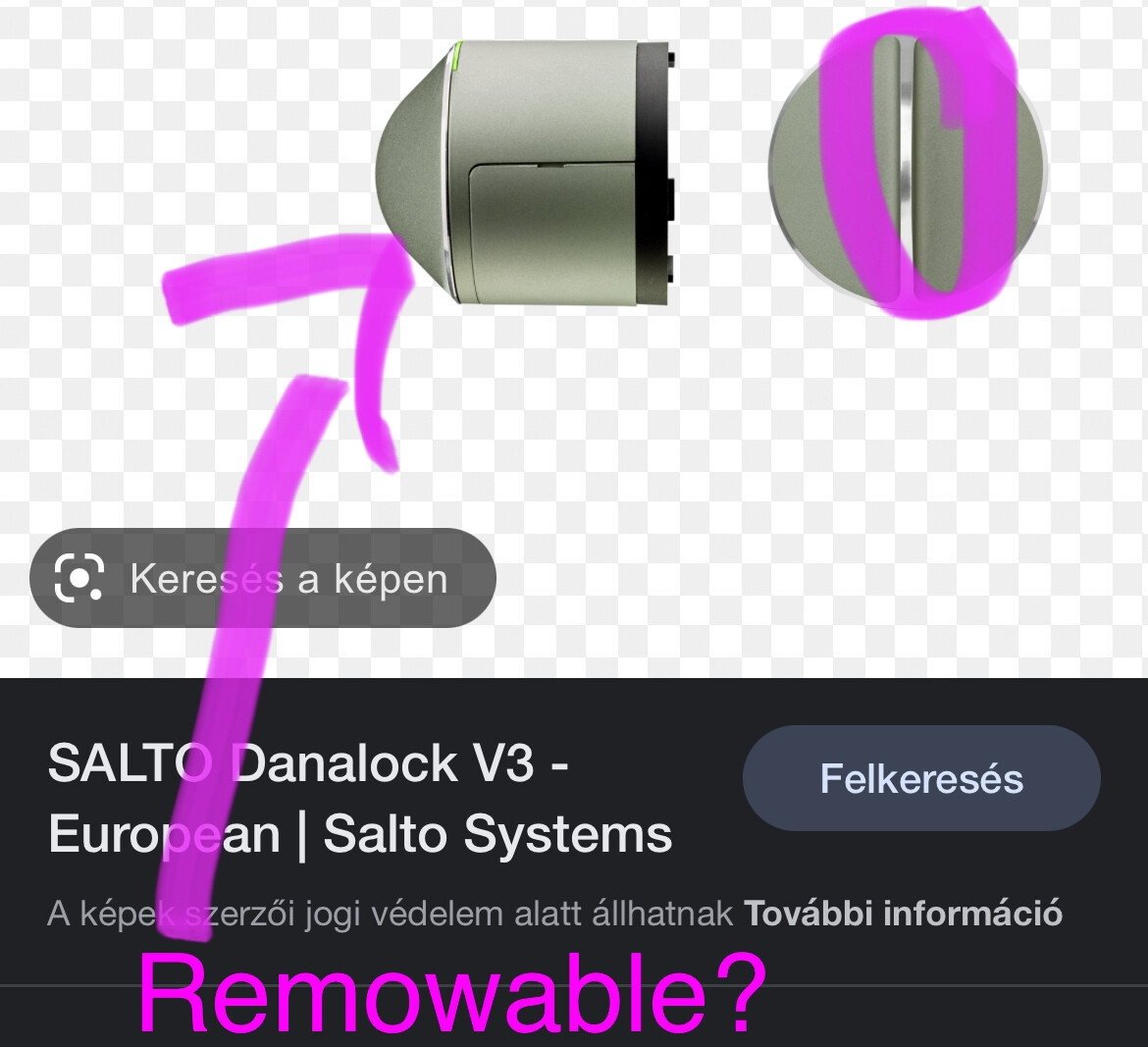

I wonder how to dismantle it? Is it possible to remove the motherboard, processor and panel from the front, or do I have to unscrew the screws at the back?
The rotating thing is fastened through the bottom. All parts can be dismantled with screws. Processors are soldered to the small boards. There’s no use in gluing anything, as you need to be inside the building to begin with in order to access the screws - at which point the lock serves no purpose anyway.
Good. So, the question is: can the motherboard be removable at the back of the lock (after unscrewing the screws) or just need to unscrew the rotating lever at the front and pull it out from there?
“The rotating thing is fastened through the bottom”
  • So to unscrew the rotating thing through the bottom, you have to unscrew a screw from the hole with a long screwdriver?
To remove mobo the knob must be removed. Yes with a normal screwdriver from the back.
Another question: the Homekit version lock has frimware version 1.1.11 (which is a very old release). How can I reinstall it (whole system) with the bootloader? Is there a solution? As far as I know, for security reasons, you can only update the bootloader once. But what if the device is not new, second hand? How can the new owner reinstall it the whole system (with bootloader) for security reasons?
Thanks for the information/help. There really is a screw in it. :grin::grin::grin:
