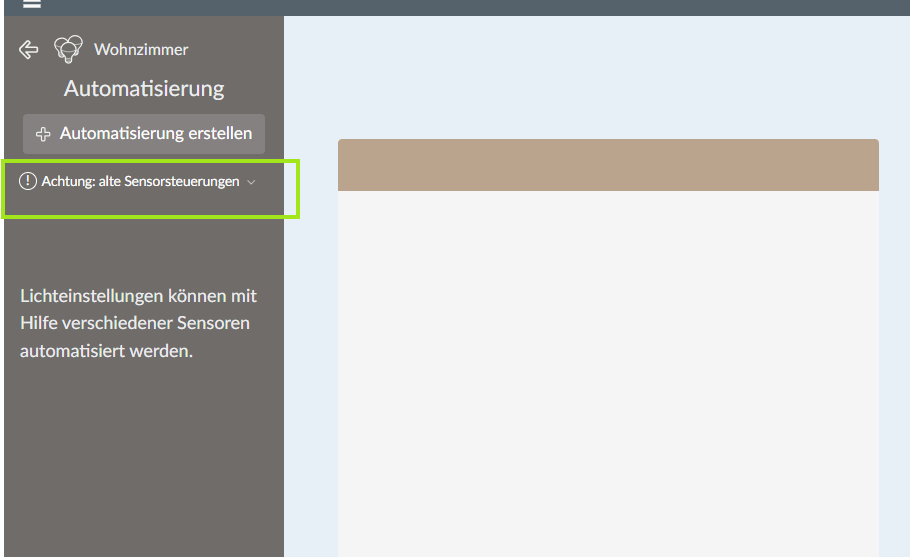

1. The UI Bug (The Blocker): I cannot delete my old “Sensor Controls”. The warning message appears “Achtung: alte Sensorsteuerungen”, but the page to manage or delete these old controls does not load. The content area remains blank (see Screenshot). This means I cannot clean up my old, conflicting rules.

  1. The UI bug:
    I see there is a bug on the automation page that says it found some old sensor control rules but you sensor control page does not list any rules. This could be because there are some left over rules or resourcelinks that cause this message. I can say the message is not as bad as it sounds, It is just there to inform the user that he should not wonder why his lights go on or off even when the ruling from his created new automation does not apply. Just because he still has an old sensor control which affects the same lights.
You could check if there are any Rest API left over rules from the old sensor control with a Rest API client when you check out the /resourcelinks endpoint and look for links with the "classid": 2020 Those belong to old sensor control.
It is also not so bad when you want to use the old sensor control even longer, if you just keep in mind that they could intefere with an automation that controls the same lights.

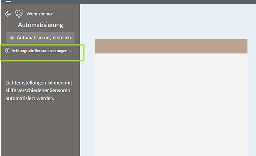

i also encounter the UI Bug, but i am missing a solution. How can i delete these old rules? I tried the phoscon app on a phone, the phoscon app on a tablet and the web ui. The rules are nowhere visible. It is always just the warning message.
Can see them direcly on the API using Phsocon/help/API Information/rules
But to delete them need to use REST request Rules
