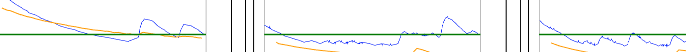

since nothing worked I gave up and used matter with home assistant.
there are some strange spikes (2 blue lines on the right are the BOSCH Matter devices, while
the left is the Zigbee device that got replaced a couple of weeks earlier)
