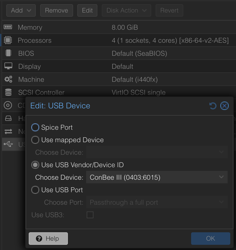

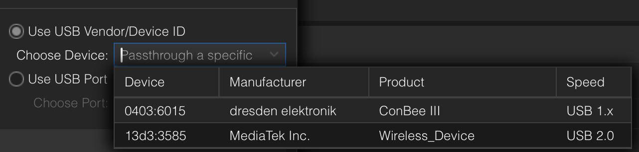

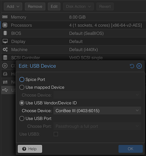

I try to setup a Conbee III in a Podman container on a Proxmox VM. The stick is recognized by the Datacenter
and successfully connected to the VM
and I can see it under lsusb on the VM
