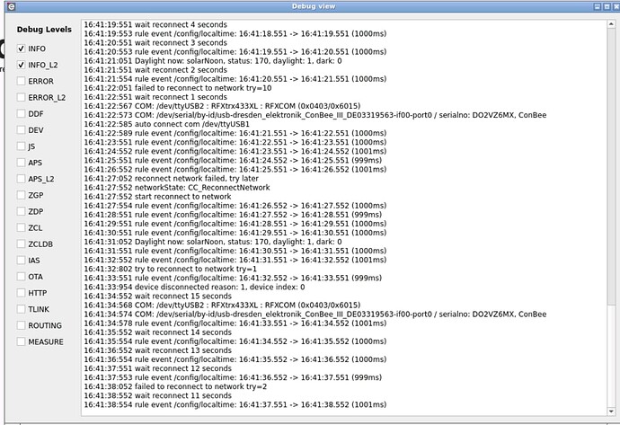

This specific log shows the sequence of events during my successful workaround. Here is a breakdown of what is happening in the log below:
  • At the start (around timestamp 108388), I restart the deCONZ add-on while all devices are connected. The add-on fails to connect to the ConBee III.
  • Around timestamp 108448, I physically unplug the hub containing the RFXtrx433XL and TellStick Duo. At this exact moment, the deCONZ add-on successfully connects to the ConBee III (this connection event itself isn’t in the dmesg, but it’s when it happens).
  • From timestamp 108470 onwards, I plug the hub back in, and you can see the RFXtrx and TellStick devices being correctly re-detected by the system. After this, all three devices work perfectly together.
Here is the log snippet:

As I review this, I realize that this log shows the recovery and not the initial failure. It might be more useful for you to see the dmesg output from a complete system reboot where the ConBee III fails to initialize in the first place.
I am happy to do a cold boot of the Pi with all devices connected and provide that entire log if you think it would help pinpoint the problem.
Please let me know how you’d like to proceed.
