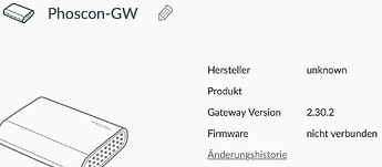

Conbee II "no firmware version" after updating Raspi from Bullseye to Bookwork
I just updated from a working Bullseye environment to Bookworm with the existing Deconz/Phoscon/Homebridge installation on my Raspi 4. Everything went well so far and all KNX-devices are functional within Homebridge. However, it looks like my Raspi lost the connection to the attached Conbee II.
