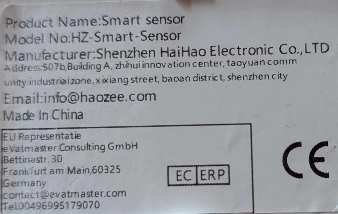

Cheap Smoke Detector doesn't show up in Phoscon (manufacturer _TZE284_rccxox8p, product TS0601)
It signals it successfully paired to my ConBee II, but it’s not visible in Phoscon (all up to date)
Is there a way to make it show up in Phoscon?
I just bought it from China for less than 10€, would be nice if it worked. Especially the the battery-level display, since the alarm usually goes off at 03h in the morning when it runs out of battery.

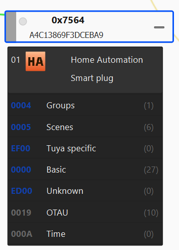

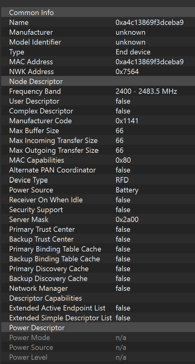

Manufacturer: unknown
Model Identifier: unknown
I think that’s what’s preventing it from being associated with a DFF.
I’m no expert, but it seems logical to me.
I think the DDF should be created.
You need to click read and click the button on the device.

Ha yes effectively, so this device need to be supported, you are sure for modelID and Manufacture name for your device ?
Because on you capture values are “Unknow”.
