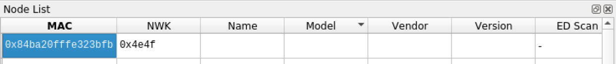

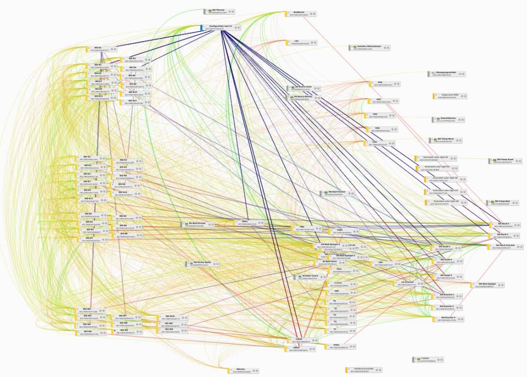

I’m using deCONZ for a two years now (~ 100 nodes) on a RPi3 with a Raspbee-II (0x26780700) without any major problems until now.
For some reason, I can’t pair Tuya-based devices anymore, although I’m already using some of them. I’ve tried to pair a new water irrigation valve (_TZE200_htnnfasr) and nothing happens. The device remains in pairing mode and nothing appears in the deCONZ-gui or Phoscon App.

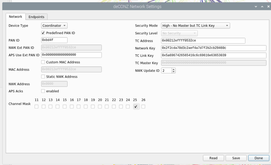

I’ve already tried without Source Routing and even moved the new device next to the RPi.
I’m already using the same kind of device for several months without any problems in initial pairing and daily usage.
First I thought the valve could be defective and therefore I’ve bought a different model (RTX ZVG1) which should be supported. But it shows the same behaviour.
In the meantime, I have paired a few Hue bulbs without any problems and the remaining devices also work flawlessly, even the Tuya-based ones. So the problem shouldn’t be hardware related.
I’ve tried to gather relevant debug logs but can’t see the main problem. Maybe someone can spot the problem?

Here are the network settings:

Have you tried the panel “Node list” ? and searching with mac adress ?

According to the “node list”, your device need to be visible in deconz (the GUI) but the inclusion was incomplete, incomplete in deconz, so in the API too.
