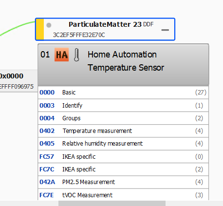

OK, I finally figured out how to get this working. Had tried pairing dozens of times! I hope this helps someone else.
The device was brand new and never before used, but I found out there is a factory reset function. Press the ikea air sensor quality pair button quickly 4 times. It reset, and instantly paired! The sensor shows correctly.
I do hope this simple fix helps save someone else hours! Cheers.

SOLVED: network masking? Don’t recall making any changes to the config, but checking the Edit->Network Settings showed the Channel Mask with only 20 checked. Checking the others brought my network back to life.
