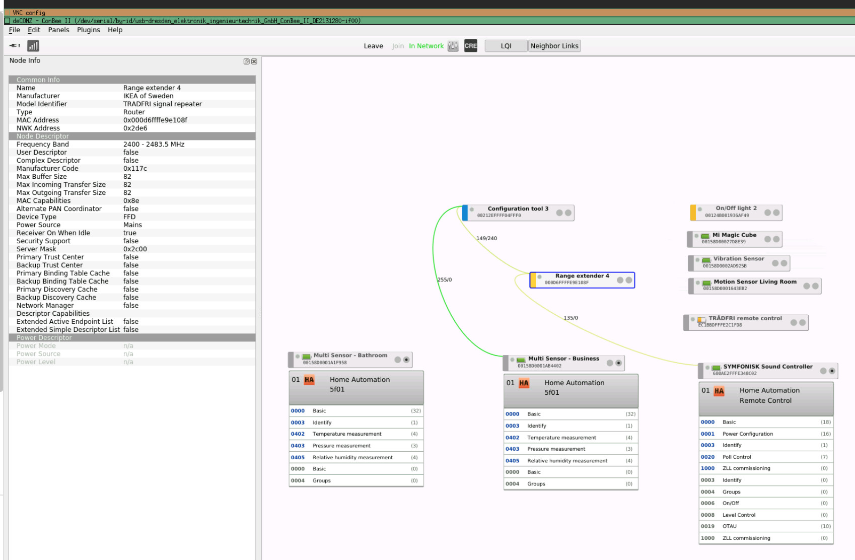

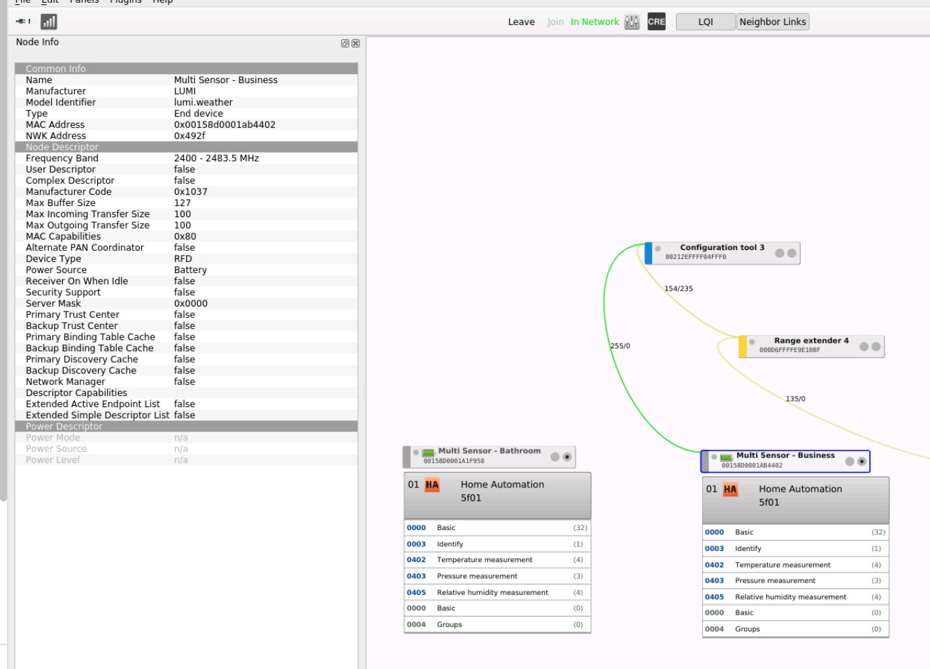

I have same problem with Xiaomi temp sensors (WSDCGQ11LM). Some of them reconnects after some minutes, some of them not.
Example:
Business temp sensor is highlighted, which reconnected after 10 minutes (I think it is ok because there is no big temp change) .
…but I have another temp sensor named Bathroom and this does not reconnect automatically until I press button on it. I am waiting now hours to reconnect, I tested with big temp change (showering), but nothing.

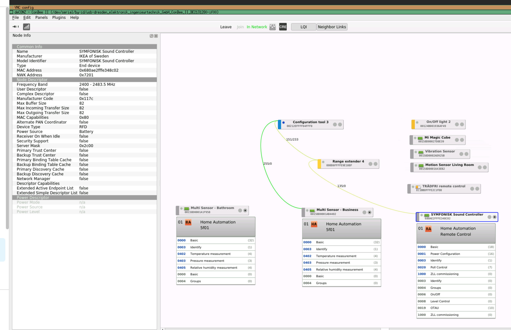

It is not clear to me, what should I see in node info? Power descriptor should be filled in all case? That’s n/a for all my devices (even those that work well).
Some info:
Ikea Symfonisk volume controller (reconnect: ok):
Ikea Range extender:
Bathroom temp sensor:
https://imgur.com/6h59zET
Grayed device mean they are generaly disconnected.
Its normal you have a disconnected router ?
Can be connection issues, you can take a look in logs to search error like thoses one Zigbee Error Codes in the Log · dresden-elektronik/deconz-rest-plugin Wiki · GitHub
For me your device look connected.
Remember never move Xiaomi/Aqara device after the pairing.
No can take 1 hout before the battery icon appear for exemple.

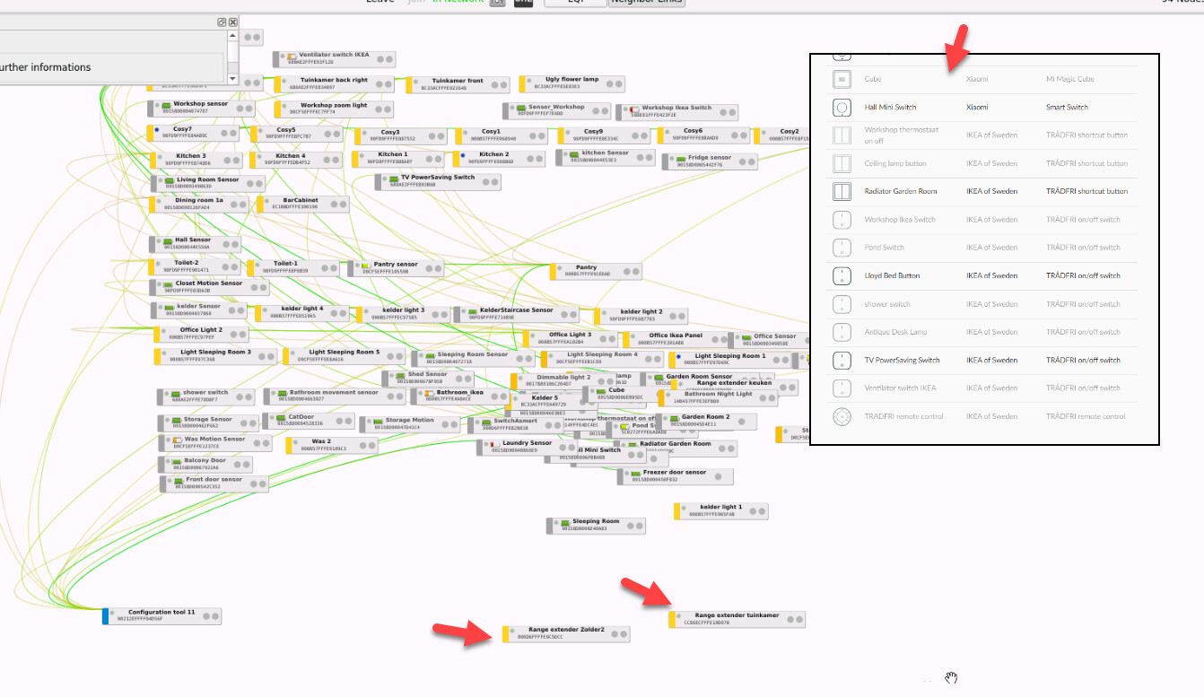

Woke up this morning to this. It happens about once a month. I’ve started replacing things with Tuya protocol instead as this is so annoying. All in gray are un-paired. Try to restart Deconz - nothing changed. I now have to manually go all around again.
My 2 range extenders from Ikea also felt down.
Following up here as things got resolved.
The Ikea Range extenders seems to cause more problems then value. I removed them
I added just a couple of Phillips Hue lights in my network instead
I re-paired everything. Lights, sensors, switches. (157 devices…)
Starting with the lights, then switches, then sensors. (Since I was unpairing/re-pairing)
The cuplprit. In my office, I have ikea panel and lights linked to an analog switch. My partner liked to turn it off with the switch - which destabilized the network across the whole house. So I installed a zigbee swith beside instead.
I also found a zigbee light that was part of a series turned off by a zigbee switch. Removed that light and replace with non smart light instead.
In other words - avoid at all cost turning off electricity on zigbee devices. 5 days so far - nothing failed.
