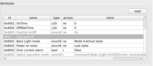

Have you tried with the GUI ? To see if the device support it ?

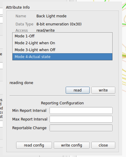

The device does support switching the LED on and off. Via the GUI it works as expected.
These are the attributes I see in the 0006 cluster:
When I double-click 0x8001 Back Light mode, I get this:
I’m not sure what “Mode4” does.
zigbee2mqtt states:
The possible values are: off, off/on, on/off

When changing the value via REST API, and then checking in the GUI, the “Back Light mode” is set to Mode 4 - Actual state when I send true, and to Mode 1 - Off when I set the value to false.
The REST API apparently does not support all 4 states, and sending true does nothing, actually.

Try the new code
"eval": "if (!Item.val) { Attr.val = 0; } else { Attr.val = 1; }",
instead of
"eval": "if (Item.val) { Attr.val = 3; } else { Attr.val = 0; }",
Like that the value will move from 0<>1, so “off”<>“on if light on”
