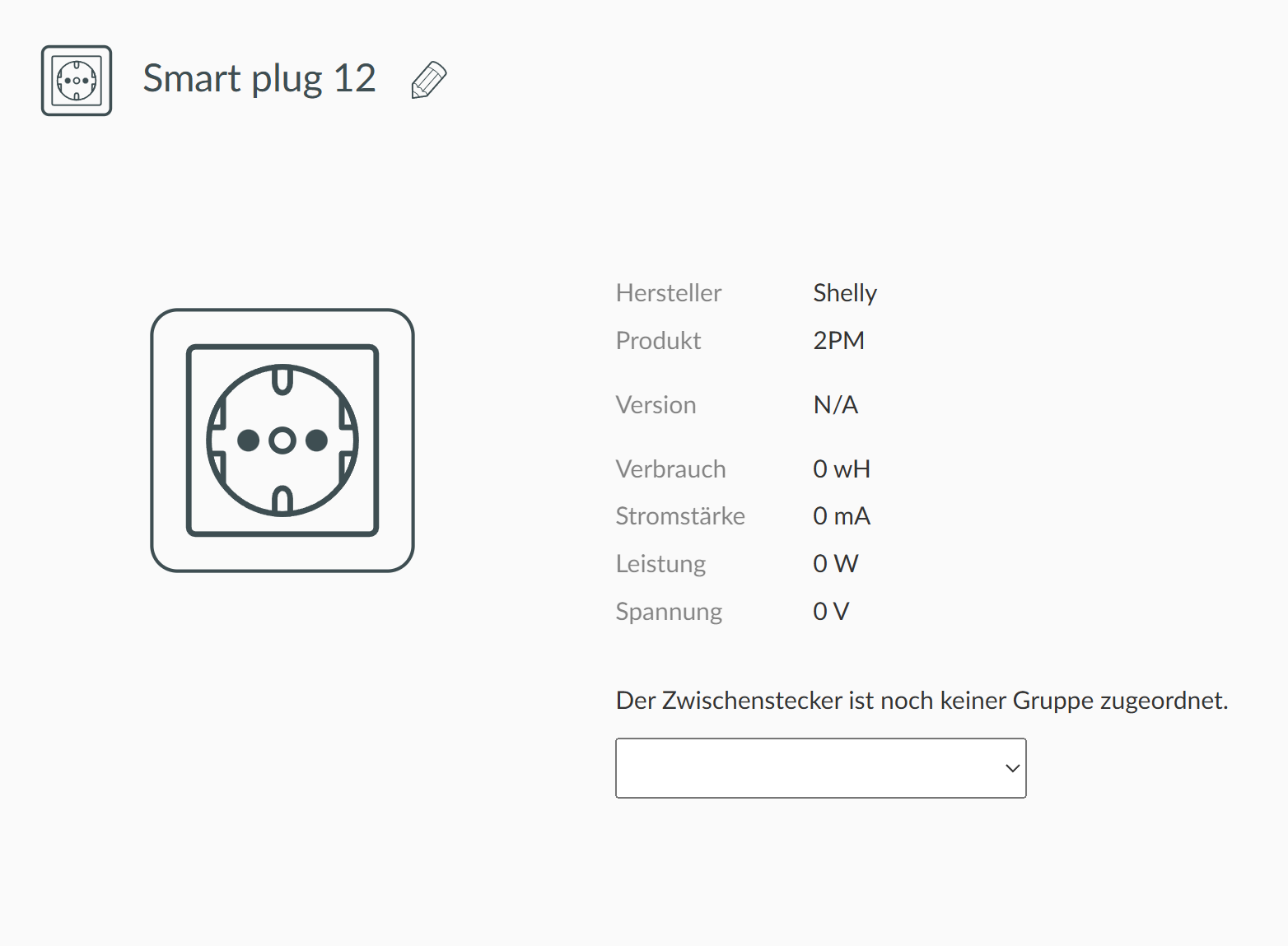

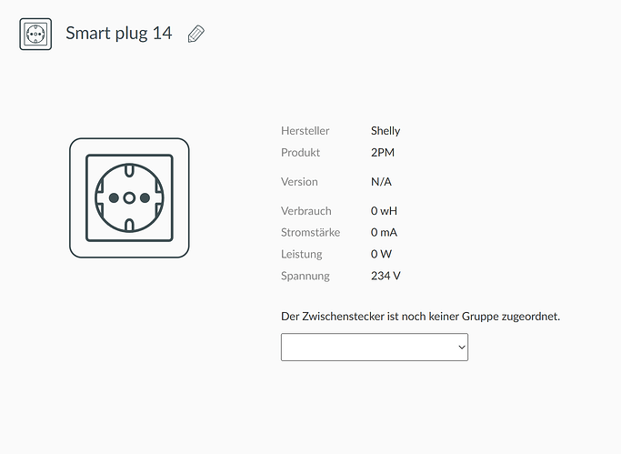

After teach-in I can see that:
Shelly 2PM Gen4, latest stable firmware 1.7.5.

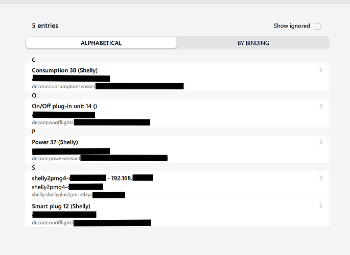

Within OH5 it looks like that:

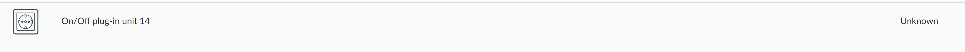

View, sorting, naming is somewhat confusing, but “Smart plug 12 (Shelly)” is switch channel 1, “On/Off plug-in unit 14 ()” switch channel 2 in OH. Power & Consumption explains by itself.
“shelly2pmg4-…” is OH auto discovery for Shelly devices, as I keep the Shelly parallel in WiFi, until OTA is finally possible and WiFi maybe can be enabled/disabled from deCONZ/Phoscon on ZigBee level …

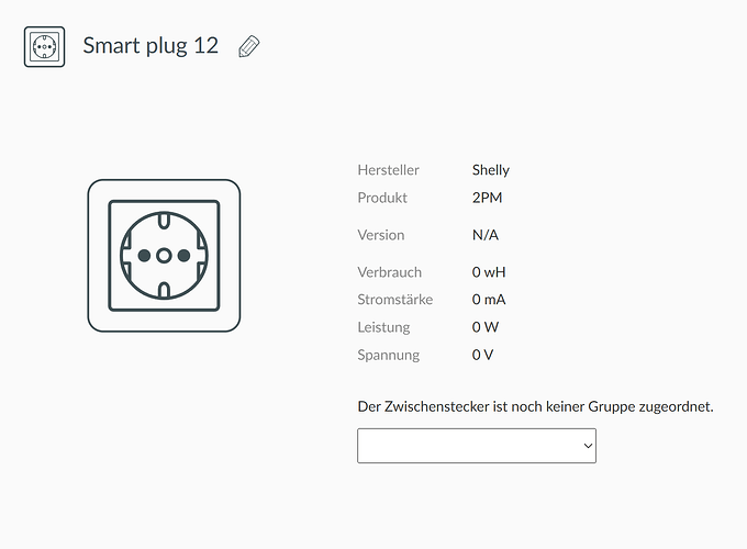

So the “Smart plug 12” seem ok, but why all values are still 0 ?

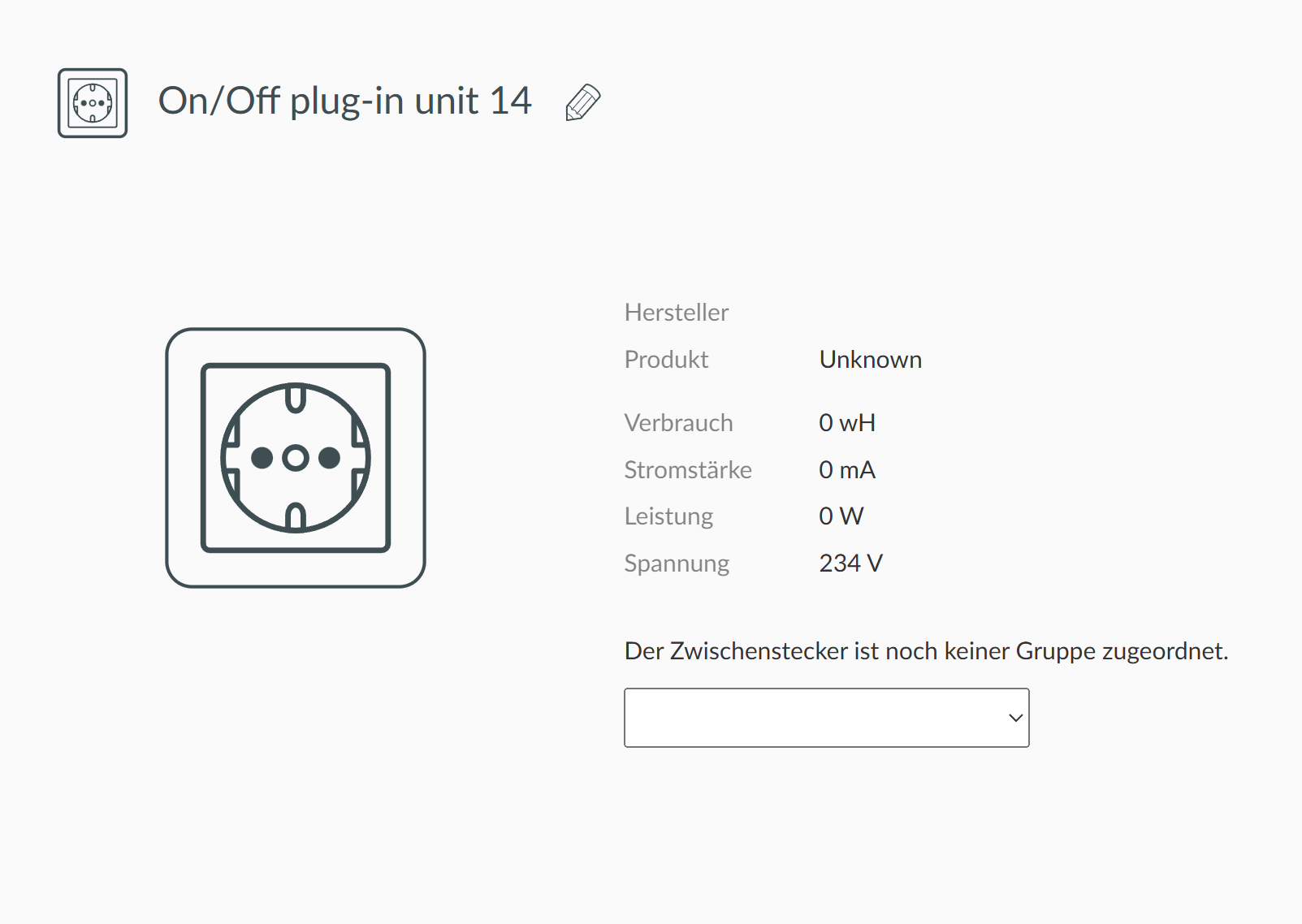

IDK what is the “on/off plug-in unit 14”, with no model ID and no Manufacture Name …
As written “Smart plug 12” is switch channel 1, “On/Off plug-in 14 ()” switch channel 2. Yeah, naming is confusing …

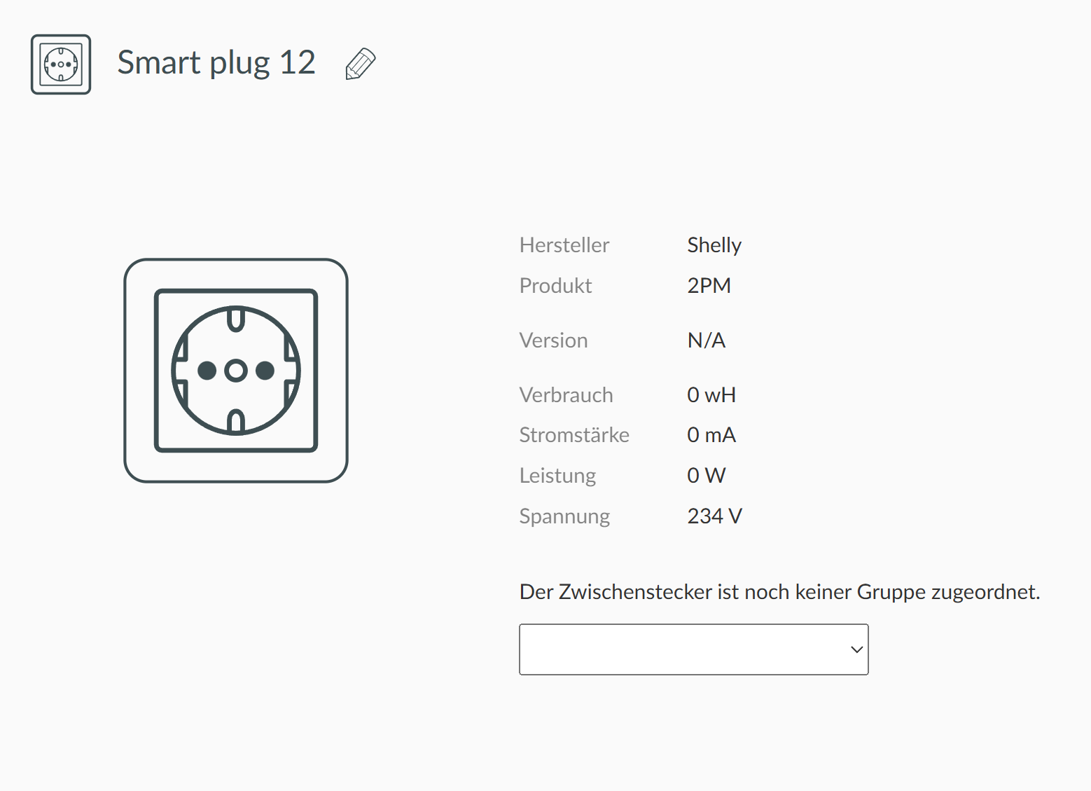

Values looks ok to me, its a 2-channel device, so you can see just one time 234V. The rest of the values are also ok, there’s nothing connected, its a test, just the “Shelly 2PM Gen4” is powered up / running. Version could be filled somehow …

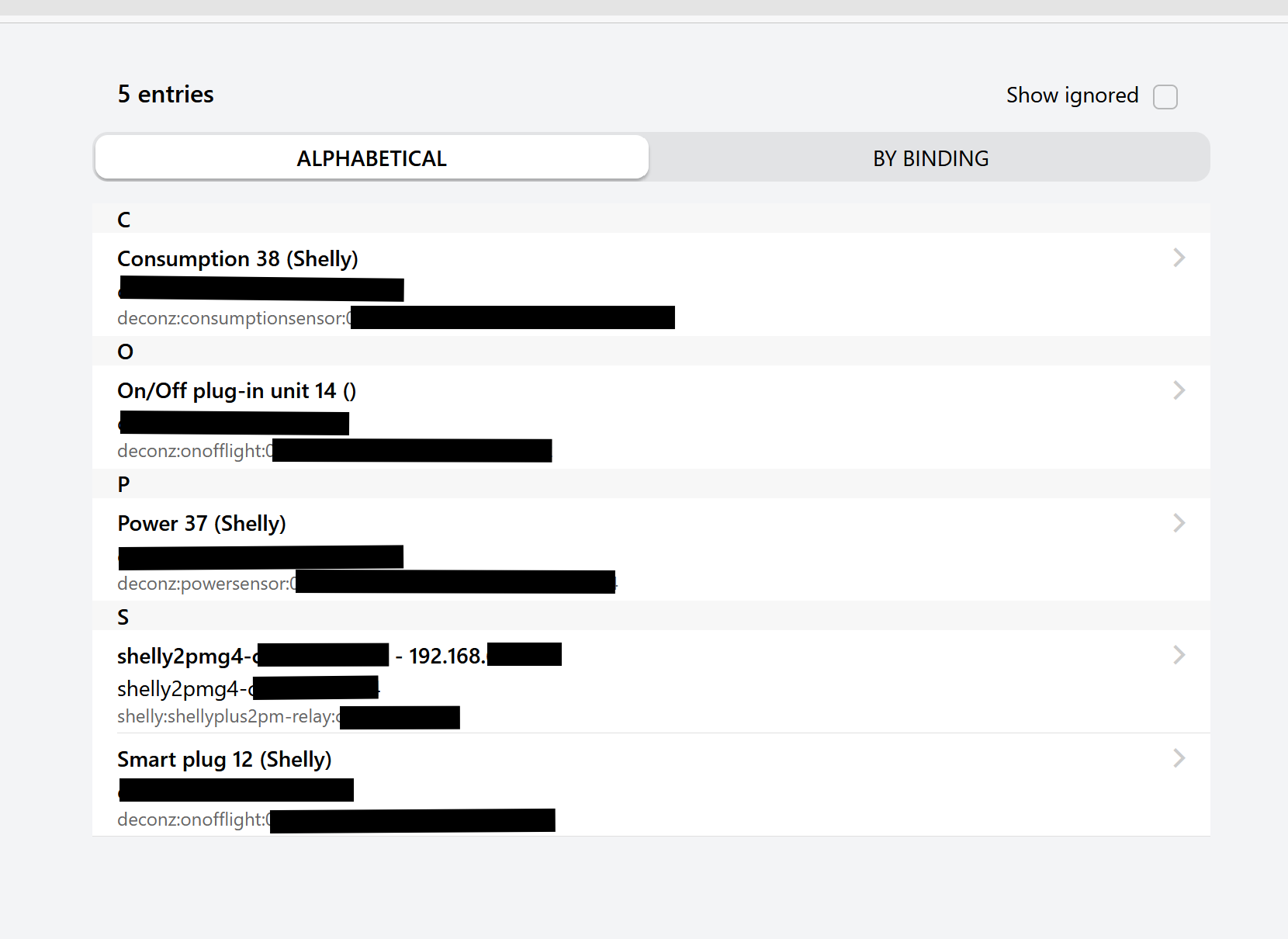

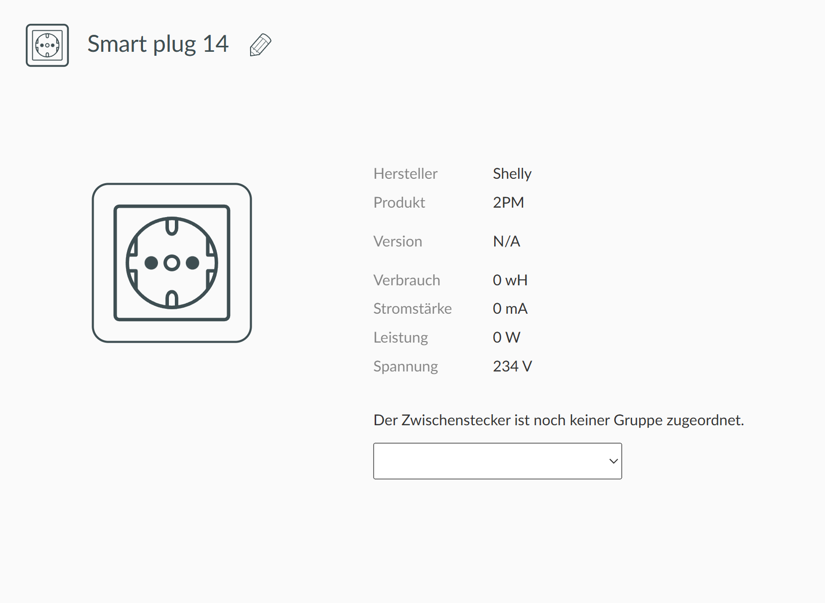

Ok, tested a try-fix within shelly_2pm_gen4_switch.json … teached-out & teached-in again, with that result:
Since it kept the IDs, it started to work again w/o changes on things/item, after ZigBee mesh got re-settled.
