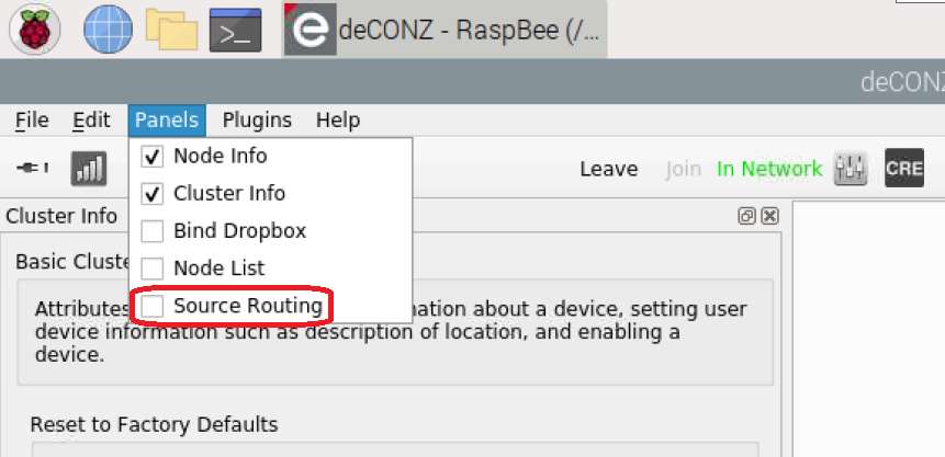

Hi there,
I am running a Conbee II on a raspberry pi with deconz gui.
When I restart the RPI all battery powered devices get connected to the nearest ac powered device.
After a while I recognize some lags in motion detectors and /or switches.
After having a look into the gui I discovery some bad connections, which I don’t know why.
See screenshot.
The “Licht Schuppen” is outside in a shed, so probably the worst connection possible.
I tried to organize it so it is a bit according to distances in real life
How can I get the two marked devices to connect to a closer ac powered device?
