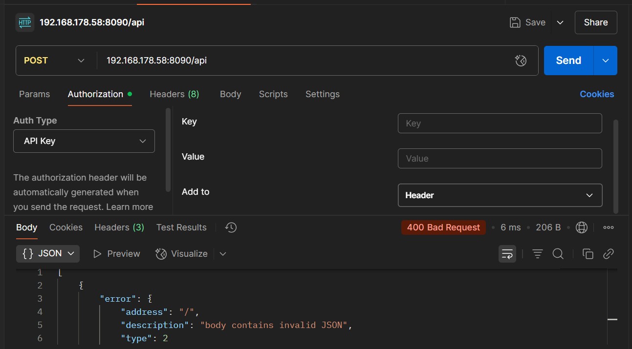

In Postman, when I try to POST “MY-IP:MY-PORT/api” it always says “400 Bad Request”
“error”: {
“address”: “/”,
“description”: “body contains invalid JSON”,
“type”: 2

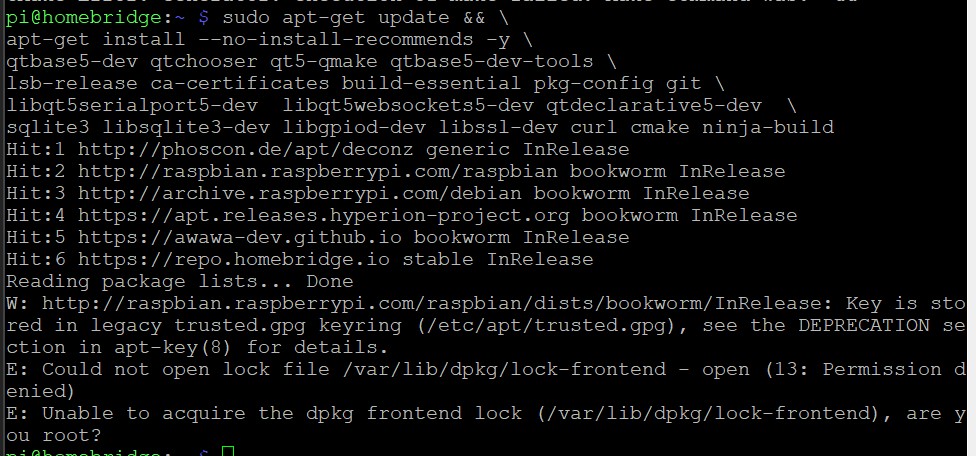

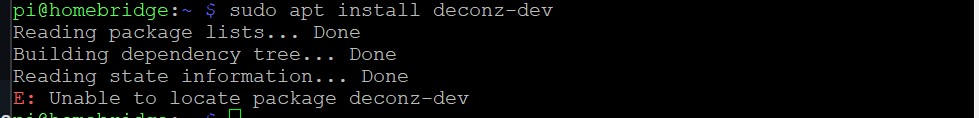

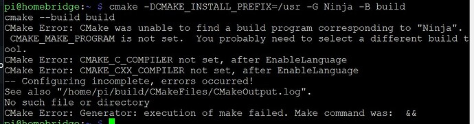

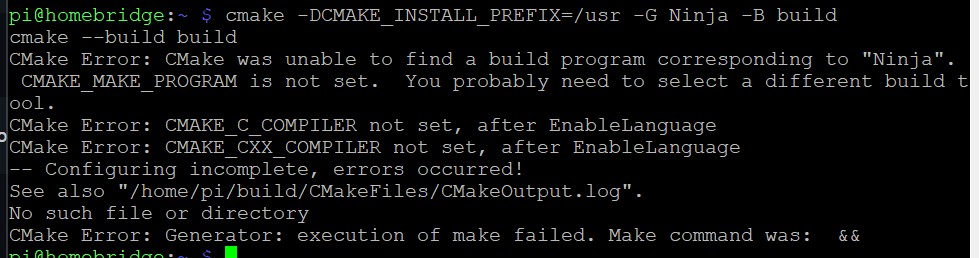

When trying to install deconz-rest-pluign, with this installation guide (deconz-rest-plugin/BUILDING.md at master · dresden-elektronik/deconz-rest-plugin · GitHub) I get various errors. I can download the repository, but when trying to compile the plugin, it says:
CMake Error: The source directory “/” does not appear to contain CMakeLists.txt
Specify --help for usage, or press the help button on the CMake GUI.
Error: /build is not a directory
Don’t know what this means and how to proceed from this point.
I copied the CMakeLists.txt to the current folder, but still there occur errors.
Postman Error:

Any advice on how to make postman work, or install the deconz-rest-plugin?

I tried another tool than Postman (YARC!) and figured out, that there must be given the payload:
{“devicetype”:“TestKey”}
to receive the key.
In the manual it says
{“devicetype”:“my application”} which does not work
