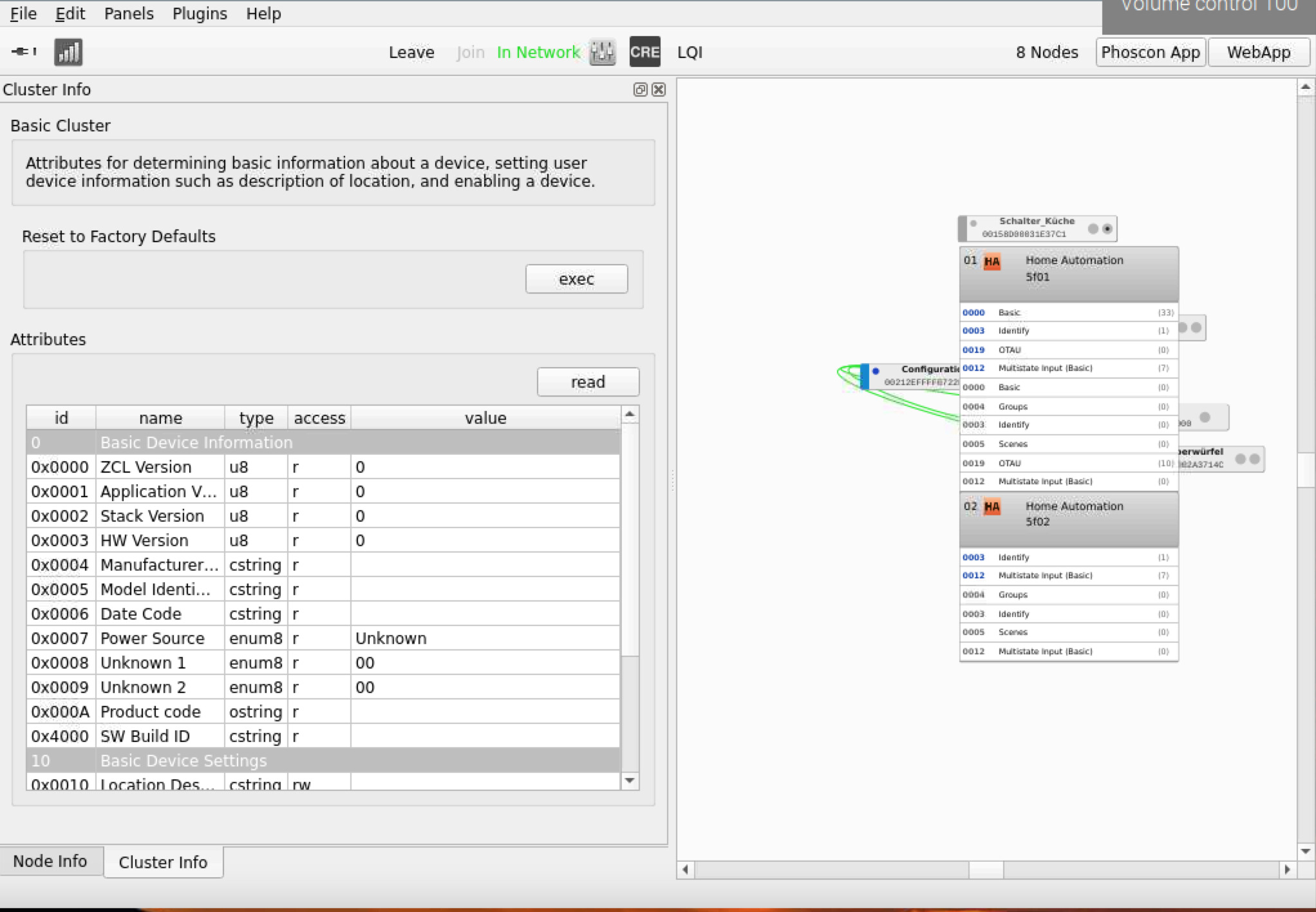

If you could give me a screenshot from the basic cluster with the attribtues read as well as a screenshot from all available clusters, I might be able to help you to prevent the device being trashed :slightly_smiling_face:
Hi Swoop,
this is quite gentle from you.

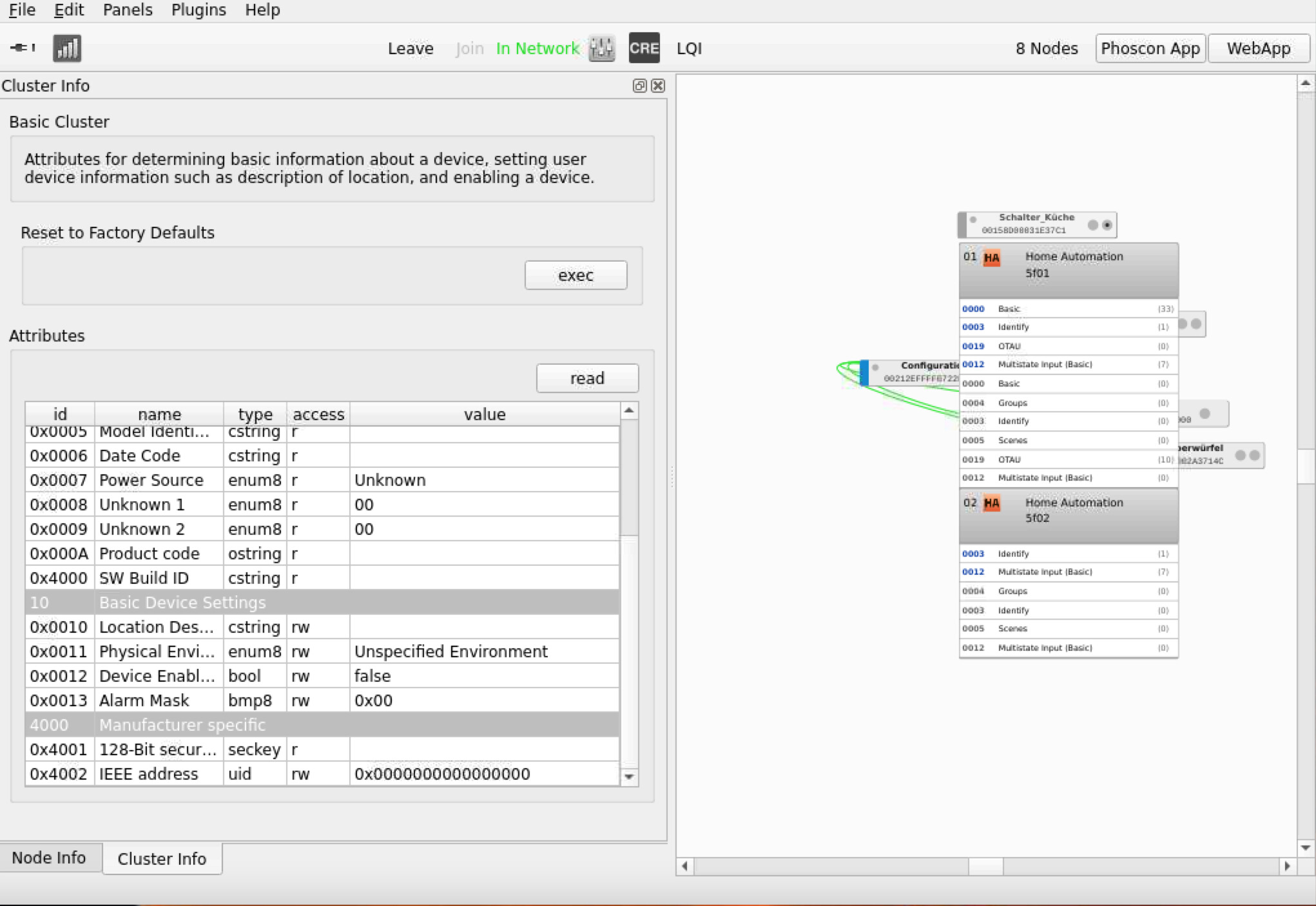

Do you mean this ?
Yes, that would be the 2nd screenshot. For the first one requested, you must select the basic cluster and then use the cluster info pane. There’s a read button, which must be pressed up to 4 secs after you pressed a button on the device to wake it up.
Also, when you make a right click on the node (just in the area of Schalter Küche), then select edit DDF, you get to the editor. Would be also helpful if you could paste the content of the preview pane here.

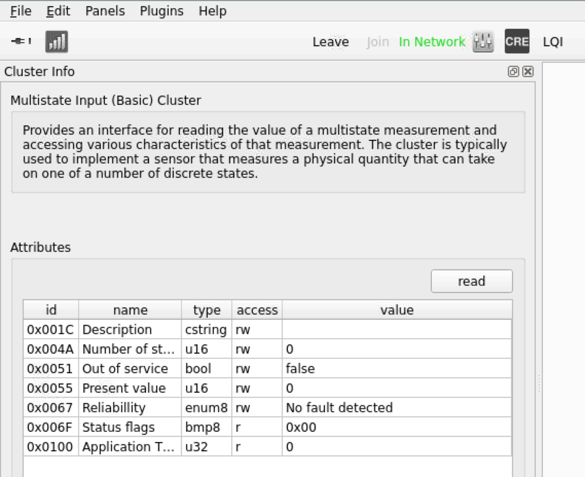

This is the information I could provide.
If I press read, the node “LED” is always red, cause of missing pairing … I think.
Unfortunately I couldn’t provide the DDF Data, because, doing a right click on the node I don’t reach the preview pane.

Hm, looks like your switch is not available. Does it blink green when you press a button? Otherwise, it might be worth to re-pair it.
For the DDF editor, right click on the node gives you the option to select it
