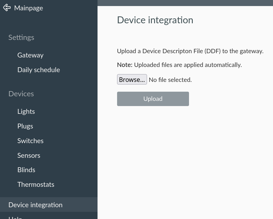

First test DDFs are open in PR #8127. You can try them with following Bundles.zip file which contains the DDFs for the Jasco lights.
This zip file can be uploaded in the Phoscon App via the Device Integration page (afterwards you may need to restart deCONZ if the changes aren’t applied right away).
Uploaded the 4 DDF files, and restarted Phoscon. Seeing lots of Delays. Here is a new debug:

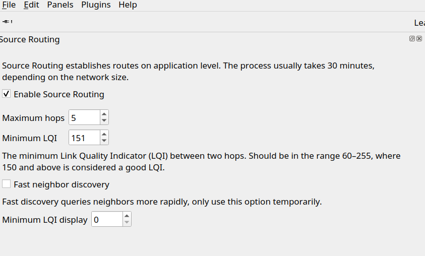

However if the delay messages aren’t stopping after ~1 hour, next up it might be a good test to enable source routing since you have a larger network.
Source routing can be enabled via deCONZ GUI → Panels → Source Routing and in the panel then click the “Enable Source Routing” checkbox (all other settings should be left as is).
Note: In larger networks it takes a while to figure out the new routes, like 30 minutes or more.

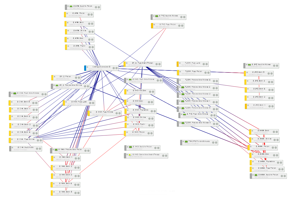

They appear as straight blue-red lines like this:
Still seeing large amounts of Delays, and have enabled Source Routing. My Minimum LQI is 130, is that the right setting?
Besides the delays, I have lights that appear to have no links/connections after restarting. If a device has been discovered at one point, why does it seem like I need to resync them from time to time?
I’ll post back later tonight to give update.
After turning on the routing and giving 2 hours, I can no longer control the lights. I have since turned off routing and the lights are controllable again.
