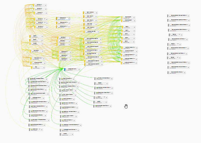

After a time, disconnected device are grayed in Deconz (the node titlebar), the “green line” can be not reliable to check if a device is connected.

The strange things is that when I restart deconz the problem-sensors are greyed out, but they turn black after a while. Still they don’t work, but they are black.

As you can see on my map, it is clear that there are not much communication to the sensors up to the right. I know they are not always to be trusted, but this is something special..

If they stay black it mean they are sending request, but which one … Nothing visible on logs ?
